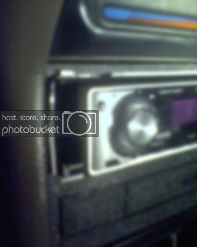

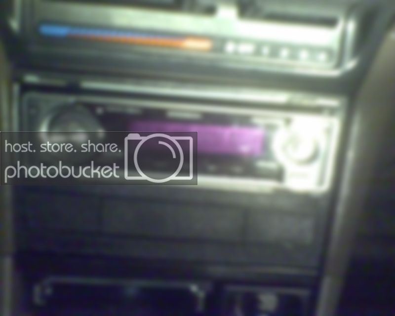

I havent messed with many head units and Im sure this is probably really easy, but I do not know how to get it out. I really do not want to start pulling the dash off.

grab flat head it pry open the dash kit. it should be held on by clips.
I started to try that, but it wasnt coming out and Im afraid Im going to break something
you dont have keys to slide it out?i lost my set once i just used a pair of scissors, worked fine lol
no keys //content.invisioncic.com/y282845/emoticons/crap.gif.7f4dd41e3e9b23fbd170a1ee6f65cecc.gif Ill try the scissors though
you need something thin that will slide inbetween the headunit and the cage that holds it in.Tha will relase the clips holding it in place.
Im going to try some scissors or maybe a butter knife

butter knives worked great.
