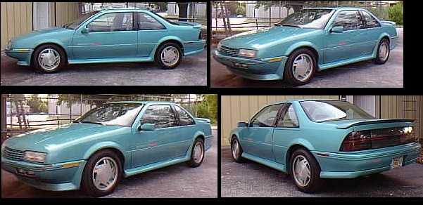

I remember at 17 I had one of these same color and thought it was the coolest car in the world but now looking back god that was a ugly car.....
^^That.
How are you 17 and have 3 vehicles?
Multiple jobs and I'm a bargain hunter. The truck was a hand me down though. Also I can pull them all together and post a pic with my user on a paper if anyone thinks I'm bluffing. I can actually provide proof lol.
I have a very rare version of my jeep It may not be a super pretty car, but the long block mopar sure is fun.
