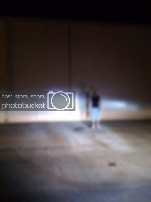

how do you like the cutoff for ebay projectors?
