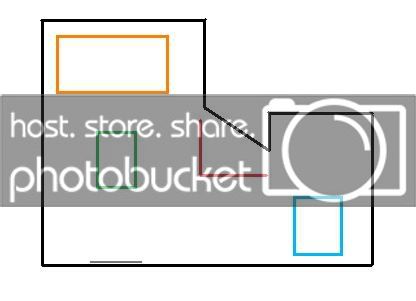

VocoPro is crap. You'll only be disappointed. I'd go with something else. You say the room is fairly large? Whats the layout of the room going to be? Any way to get a drawing? Where stuff is? where are people mostly going to be? I really think 4 10" 3-ways are going to be a big much for a basement. You should be able to get away with less.

orange = tv area
red = bar
green = pool table
blue = ping pong table
gray = dart board
those aren't to scale just giving you an idea
they would prefer keeping the audio in the orange section, can go outside if it has too
people will be around the bar mostly, would rather have it more on the loud side rather then surround

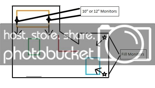

I'm still looking for the stuff to fit under your budget but this should give you a general idea of placement. The fill monitors should be something small. I'd like to tell you to use some EVIDs but it's not going to be in your budget. You'd want to look for something small that you could hang in the corner, otherwise it's gonna be pretty dead over there based on the room layout.

that looks like exactly what i was looking for on the spot, i appretiate your help.. any recommendations on products would be great
Sorry I've been pretty busy I haven't been able to try and find specific stuff to recommend. Using Pro-Audio gear is definately not going to be in your budget, but it shouldn't be needed for a basement setup. I'm leaning towards an older B-stock receiver for the processing and amplification. This will allow more money to be spent on speakers and give you the best power to price ratio, as long as your not worried about having the newest HDMI or 20 different types of derived surround sound modes.
