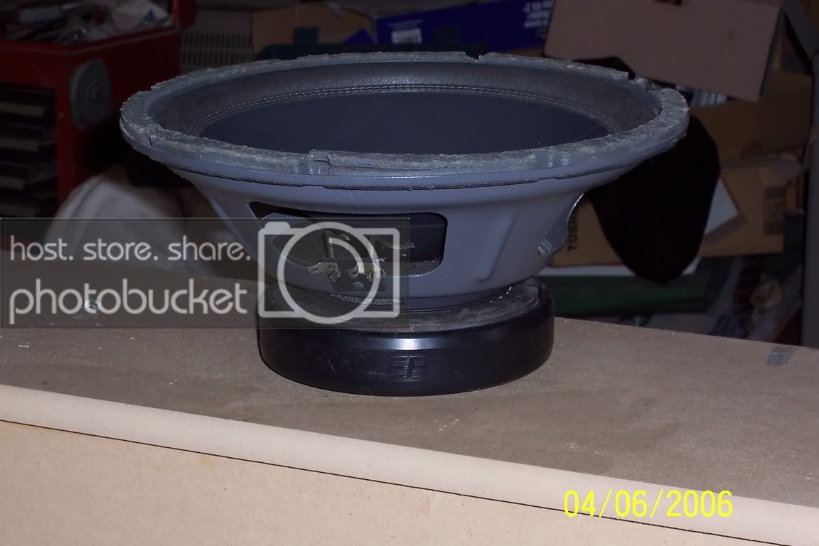

I recently came across a pair of these

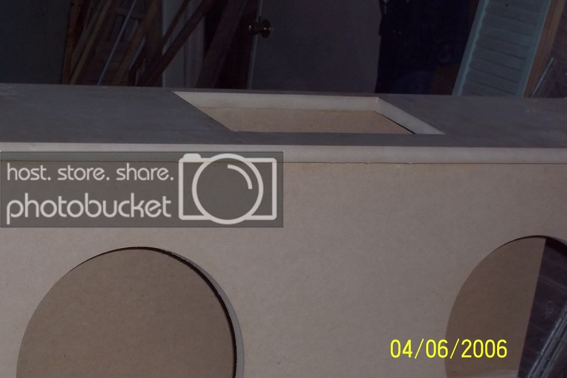

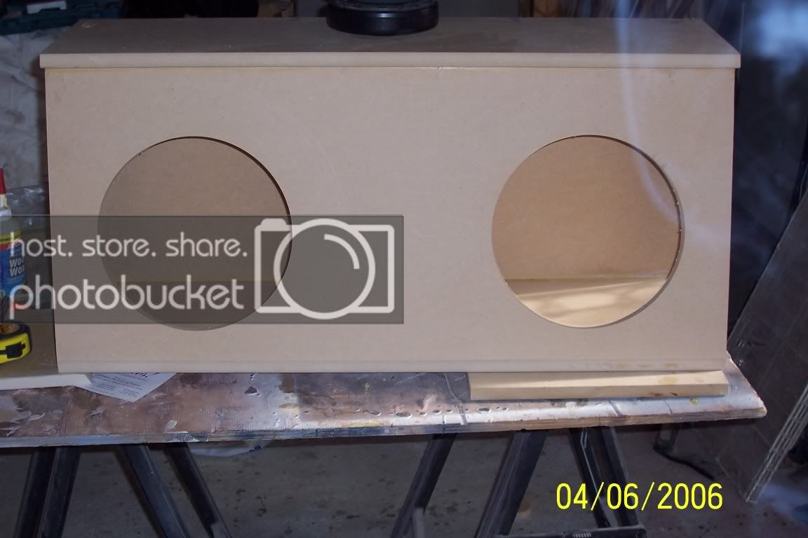

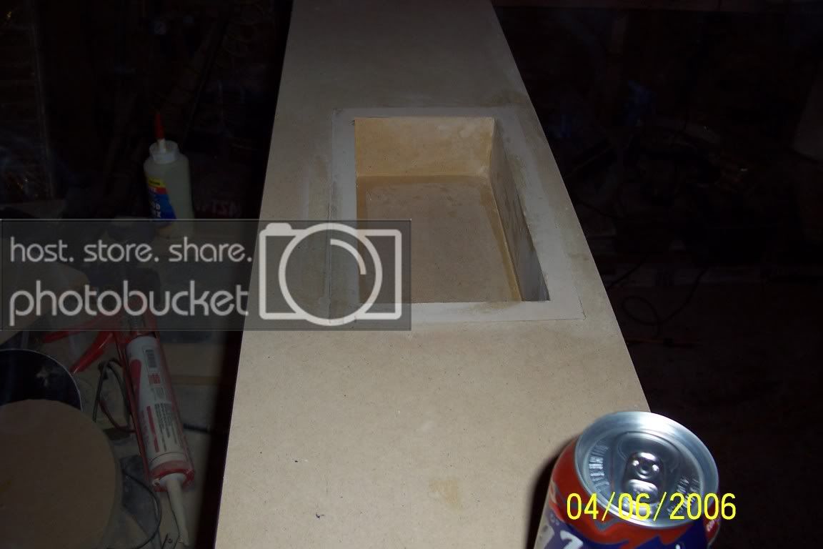

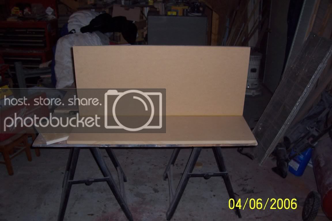

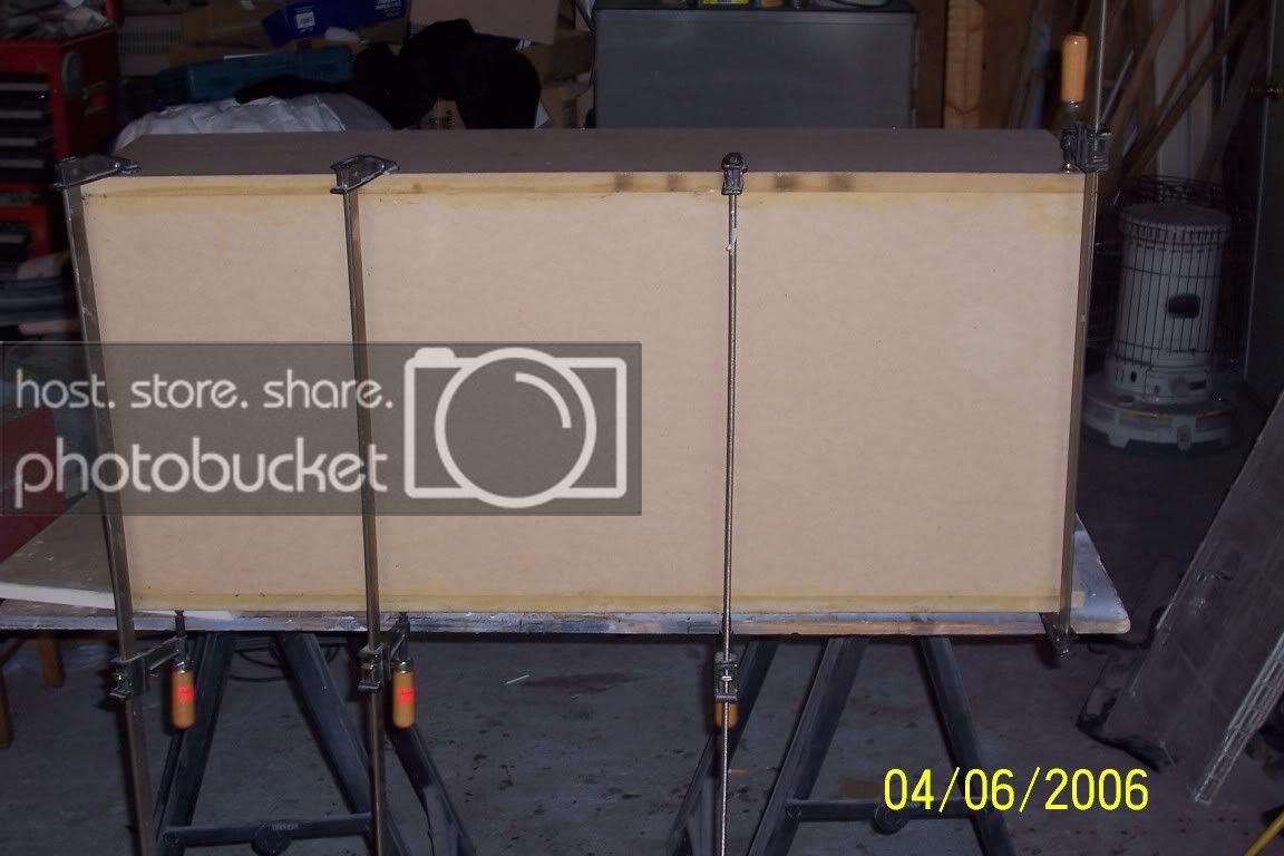

Decided they needed a new home. Soooo off to lowes I went picked up a sheet of mdf. Broke out the pencil and paper and got to work. The original solo ***** are meant for tiny under 1cuft per sealed enclosures.
D@mn that looks like 3-4 cuft. Way to big for those subs. What the he!! is ramos thinking.
What the he!!, now the crackhead is porting it ????
nope something else is going there //content.invisioncic.com/y282845/emoticons/wink.gif.608e3ea05f1a9f98611af0861652f8fb.gif
That enclosure is still way to big isn't it ??
Nope, take away the amp racks and the power distribution box and you end up with 1.5 cuft left over, .75 per. D@mn near perfect . More to come later //content.invisioncic.com/y282845/emoticons/smile.gif.1ebc41e1811405b213edfc4622c41e27.gif

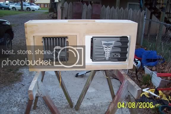

what series rockford amp is that i got one like that looks like the z series
Thanks guys, should get more done this weekend.
It's a "a" series 200a4. D@mn strong amps. Just wish they didn't bridge the farging left and right channels together //content.invisioncic.com/y282845/emoticons/furious.gif.fc81ca146dbff91fede3ed290dbc4f4c.gif//content.invisioncic.com/y282845/emoticons/smile.gif.1ebc41e1811405b213edfc4622c41e27.gif
