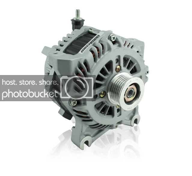

My mechman is great. I actually sit almost a full volt higher than the stocker.
