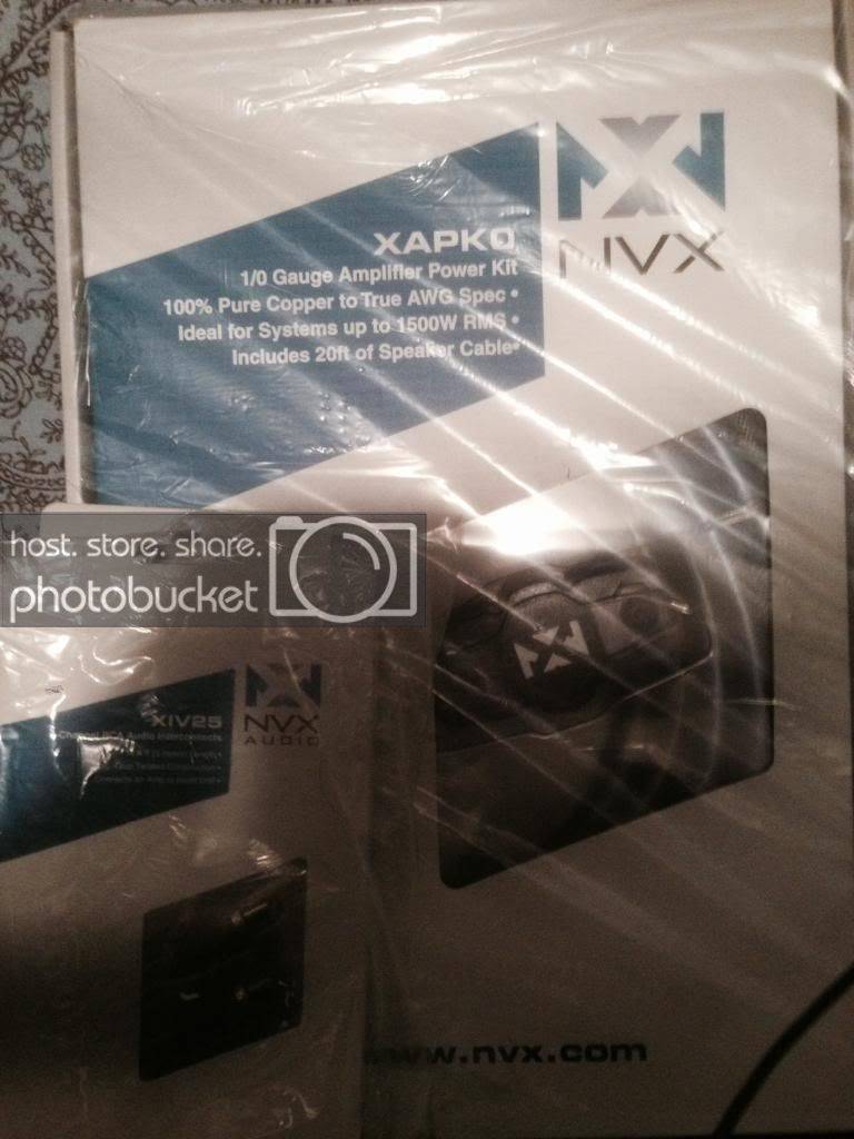

Yeah it's really pricey lol like $300-$550 for my civic si. I'm wondering if I can get away with putting 2 Optima Yellow Top Batterys in my car one under the hood and one in the back in the trunk. Those are AGM batterys right ? I read pretty good reviews about them. Yeah I plan on doing the big 3 soon, any big 3 upgrade kit you or anybody else recommend? Also I bought this amp wiring kit was wondering if it'll be able to run everything smoothly they are 100% pure copper true 1/0 gauge wires but I see their rated for only 1500W RMS ? My amp is putting out 2400W and 1200 or less to each sub, so will this work or..?
NVX wires are decent, its Sonic's in house stuff and they do care about quality when it comes to their own product if its really 0 gauge then there should be no problem running those wires with the alpine amp. Optima Yellow tops are hella expensive. Some forum members have connects to batteries can chime in on this and help you get a great battery at a much lower price. As for the big 3 kit, i'd recommend Knukonceptz OFC or have Mylows10 put together an OFC kit for you. OFC = oxygen free copper fyi
