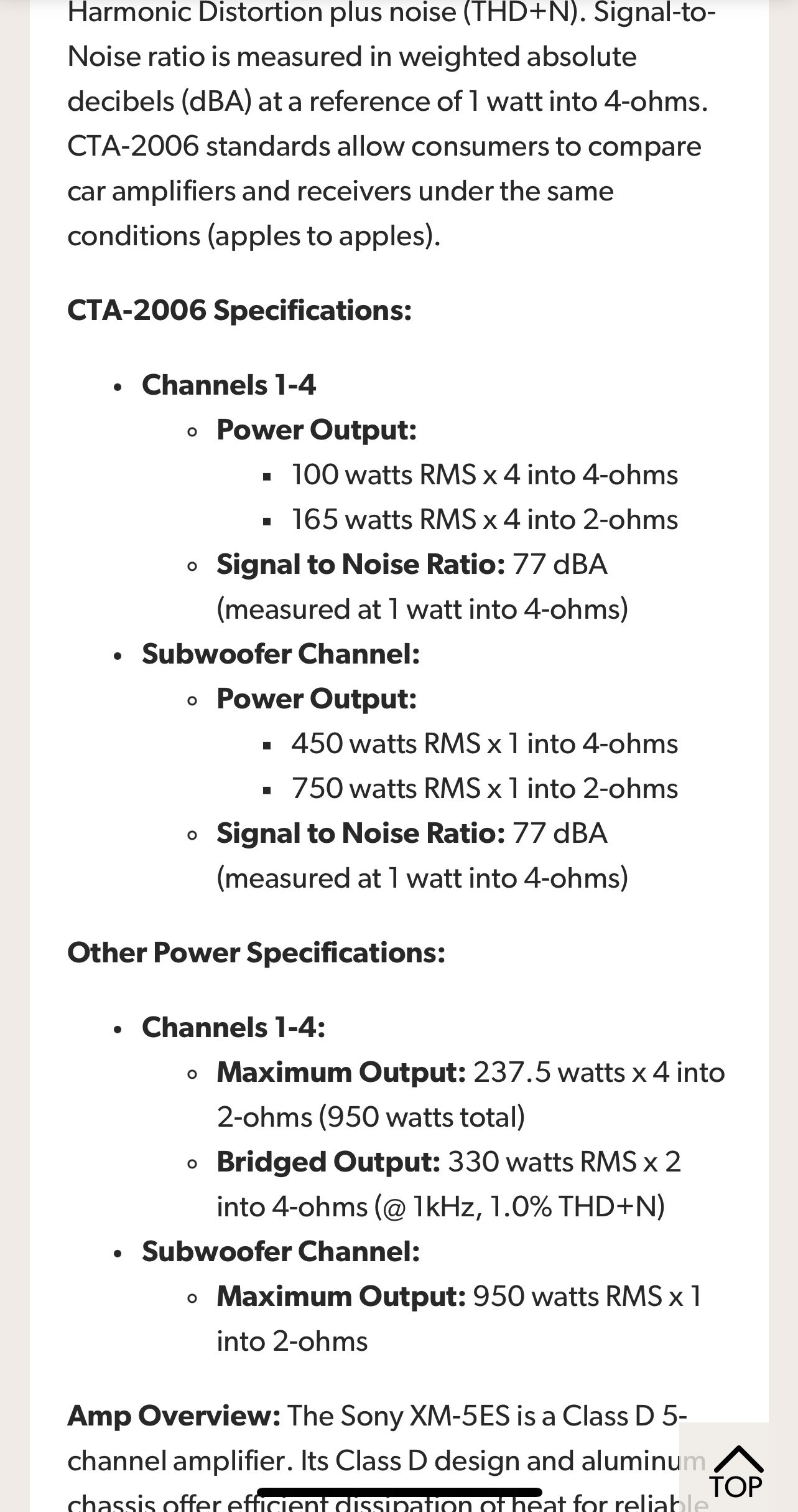

Not sure what that means as of yet. This is a snapshot that may provide some answers:
I think that he's considering the Sony XM-5ES 5-channel car amplifier
  • 100 watts RMS x 4 + 450 watts RMS x 1 at 4 ohms
  • 165 watts RMS x 4 + 750 watts RMS x 1 at 2 ohms
  • 330 watts RMS x 2 bridged at 4 ohms + 750 watts RMS x 1 at 2
That could work. Albeit a little underpowered and for the price, I'd do a couple of other amplifiers.
Suggestions?
