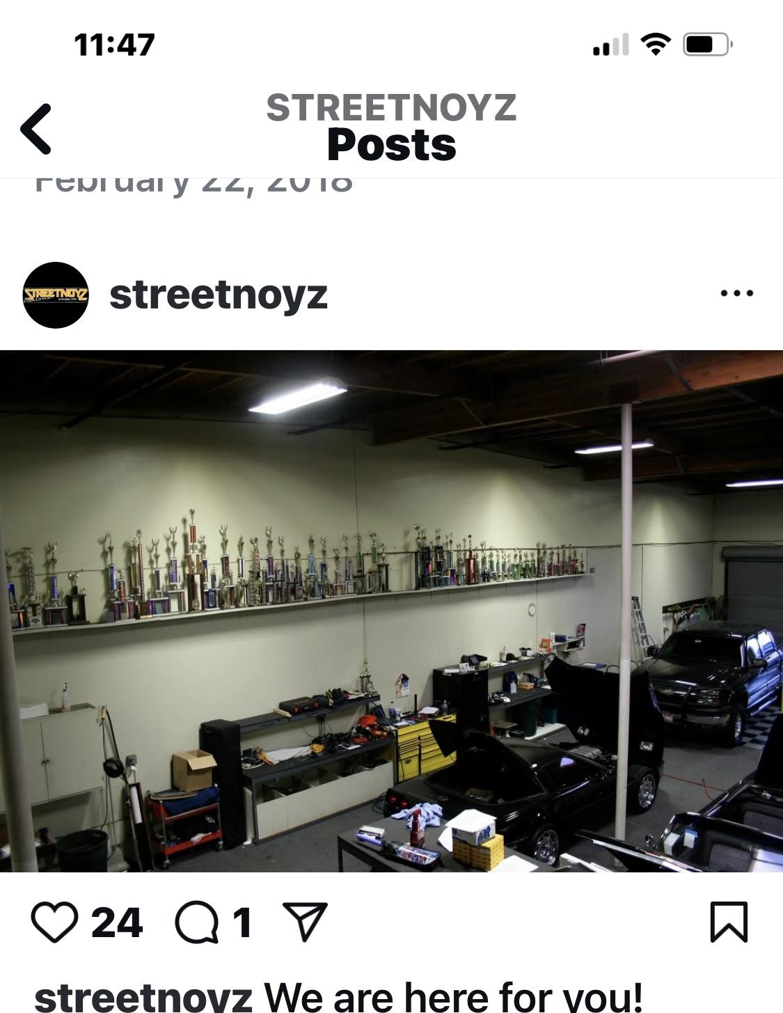

I like the K2s, but they are overpriced IMHO. Demoing in a car is better than on a sound board, but each car affects sound differently. If the guy is an award winning sound competitor, then of course his car will sound awesome. But keep in mind he's not going to spend months geeking and tweeking you system and IMHO, that's were most of the gains are.

Given the trophy collection, I'm sure he has his work truck dialed in too. If you're willing to pay what he charges to install and tune, then I'd go with this guy. Like I said I think install is more important than equipment. If he's at a shop selling Focal, then I'd probably just go with the Focals.

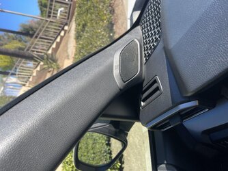

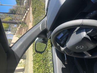

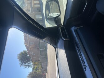

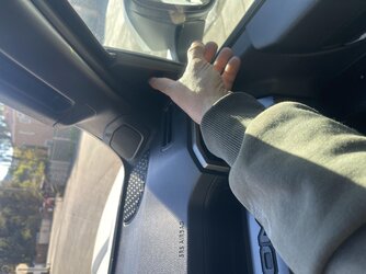

So going with the focal k2 3 way with the frak tweeter.
Mid will be mounted in the dash.
Put the tweeter in the factory a pillar location & get it somewhat on axis?
Or
Get these pedestal mounts & really have them on axis?
Could mount over the tweeter grill, or on the panel by the side view mirror, above the door panel….
The installer did say he can easily fab something but he also commented he liked the mount….

I'm not familiar with that tweeter, but past focal tweeters tended to sound best crossfiring in the a-pillars off-axis. For best results you should test different locations and aimed on or off axis.
Install will be more important than brand, all things being equal is a myth. Its never the same as install/staging/deadening and tuning are what dials it in imho.
Esoteric hi-dollar brands sprinkled with unicorn dust won't top a well thought out and executed install.
Focal tech support is stating these sound best on axis as much as possible, that's where they shine...
Maybe, but in a car you have lots of reflections and being on axis can introduce nasty reflections that there is no way to account for until you start experimenting in the car.
