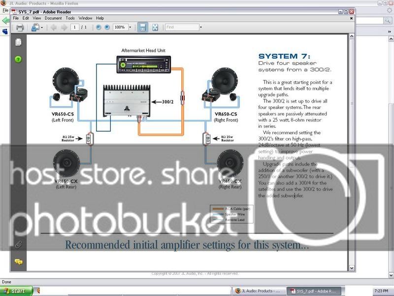

i found a local deal on a 300/2, think imma pick that up. i also looked on the jl site and apparently i can get 2 25w's from the 300/2...
but how do i go about doign this? it says theres two 8ohm 25w resistors, is that seperate things that ih ave to buy to make it work? here's the pic
googled it, is it something like this that i'd put in between the + speaker wire goign to the rears?

The resistor is used solely for attenuation purposes.....to attenuate the rear speakers.
It isn't required.
But yes...if it were something you wanted, you would have to purchase it separately.

Can you verify that it's the right way to do the connection and that it is the right resistor?
inline speaker wire connection with wire going to xover-> 25w 8ohm resistor -> rear speakers
I assume the fronts will still recieve roughly 150watts, rears only getting 25w (just need a little fill for rear passengers)

I'm going to sound like a dumbass but are you sure? If your 300/2 does 150x2 and you are splitting it between 4 speakers, you'd be getting 75x4, roughly. So these are the 2 things that I'd question:
1. Does the resistor affect sound quality in any?
2. Would that resistor only give 25 watts to the rears or would it take away 25 watts from the 75 going back there and end up sending the rears 50 watts?
