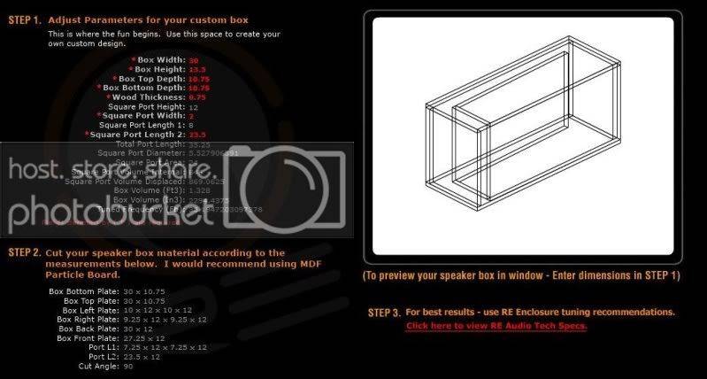

Can anyone tell me if this box design looks like it will work well. It's for a Hertz HX 300D.
dimensions: 30 x 13.5 x 10.75
1.328 ft^3 minus .1 ft^3 (sub disp) = 1.228 ft^3
24 in^2 port area
35.25 in total port length
should end up being tuned around 36 hz
Thanks
