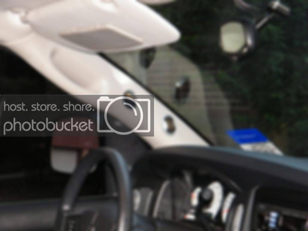

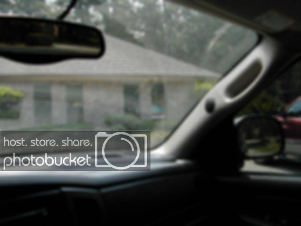

Found a pic of my older K2P tweets installed. Should they be lower or in the dash firing up from the stock location?
Definitiely a bit lower and aiming into the middle of the windshield. This will give the sound some time to mature before reaching your ears. I would say move it down another 3-4 inches.
Ok, so 3-4" lower and rotate the tweeter inward more so its aiming more at the middle of the windshield? I can give that a shot. I found replacement pillars for 90$ new shipped which sux but I dont mind cutting these up to find the right location. I assume dash firing up from stock location is bad idea?

I found this pic. Is this to low?
http://media.photobucket.com/image/dynaudio+242/moob2008/Toyz/004.jpg?o=1
Why not just move them around without making the holes first to find the ideal spot for them? Yes, they might stick out a bit but I think you would have a better idea as to where to place them. Actually, since you are buying new pillars use the existing ones and make holes at different locations to find a suitable location before you install the new pillars.
That is exactly what I am doing lol. I have already made one set of holes about 4" lower then my others and it sounds better already. The highs and mids are starting to blend better. I will try this out for a couple days then make another set of holes lower and see how that sounds.
