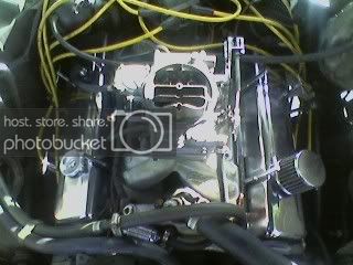

in the picture the square part closest to the front is the choke i have just been leaving it open because when its closed it wont start or even run if the motor is on and i close the choke it shuts off so the only way to run it is open

FYI....carb in the picture is a vacuum secondary. Trying changing to a heavier spring, so it won't open so quickly and richen up too much. Also fresh plugs, clean oil, general tune up...
o well idk the spring is a little loss on it if i cut it a little shorter should that help?
and i changed the plugs and all that before i went in for the 2nd time so the only thing that it could be in my mind is the carb i mean it is old i think it might need a rebuilb because im getting a little better pick up after changeing the leaking gaskets but it seems like somethings wrong with my carb like its robbing power from her
its my carb the adjustment screws are all wrong i set them to 1 1/2 or 2 turns out on each side and i checked them when i got home and they were like 4 turns out
what should i do buy a new one, used one or just rebuild this one???//content.invisioncic.com/y282845/emoticons/confused.gif.e820e0216602db4765798ac39d28caa9.gif
o and by the way i put 2 new tighter springs on it helpd it alot its not so loss any more
