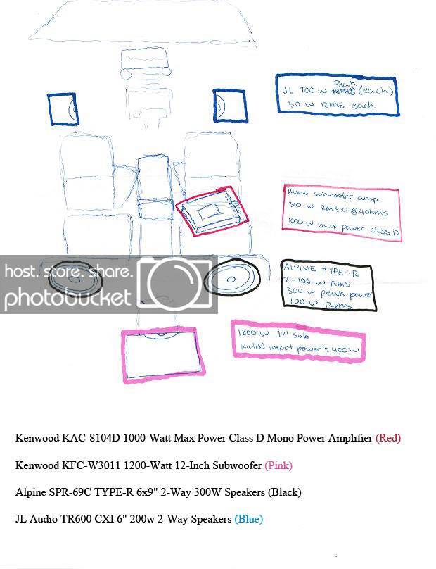

I made an illustration describing my complete set up, because It can be confusing with words:
Now, My Question
I want my car to be louder (my friends subs hit a lot harder [2 12's] and I'm Jealous). Do I A) Add another amp just for my 4 standard speakers, and keep just one sub or B) keep the standard 4 connected to the deck and buy another same 12' sub, swap out the current amp with a bigger one to power both?
I hope my question/drawing makes sense and I really, really look forward to your input.
Thank you!
-ViG

I never recommend running aftermarket speakers on a stock deck. My vote is for a good 4 channel amp for your speakers first. Then, as budget allows, upgrade to either more subs or a better sub. But before you replace your sub - RELOCATE IT. try moving it to the rear passenger corner of the trunk, aimed to the driver's side. This will corner load the sub and increase performance by reducing phase interference.

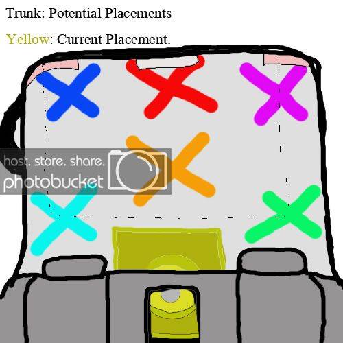

I was wondering if you could elaborate a little bit more on subwoofer placement, this is really interesting to me. Where exactly in my trunk should I have it? In the rear passenger seats there's a little opening to the trunk eh, id say, 2x1 feet or so. I have my sub facing out into this hole. The box I build for this sub has a air port in it as well. I drew another picture with my trunk and was wondering if you could suggest the best placement for my box:

if you have a seal around the enclosure to the rear seat opening, it can work. I tried that, and it worked well (both sealed and IB) but output was a bit lacking.
Then I moved it to the Blue X and it was much louder, much more punch, etc. Avoid the Cyan, Green, and Orange X locations. The direct path and the path reflected from the rear trunk wall will give you cancellation for frequencies who's half wavelength is close to the difference in those two paths. Essentially you'll hear both paths (and a lot others) and phase interference will cause a reduction in output.
