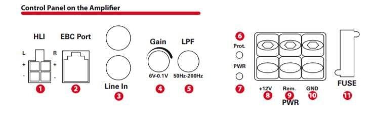

EDIT: Something weird I just noticed. The gain dial on the sub ranges from 6V-0.1V. That is, fully counterclockwise is at 6V. Is my Gain dial reversed from the normal "Clockwise is more gain"? See attached pic.
