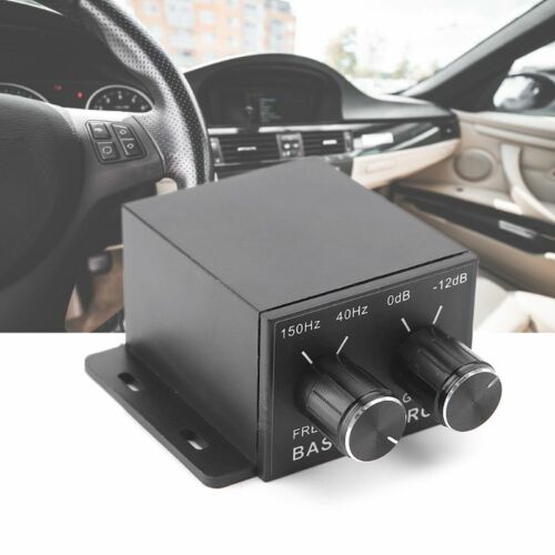

That bass control works great. I have that same one but in metal housing. FYI, it only filters up to 250 Hertz. So if you want volume control for the 6x9s, it is better to get one without the filter option.
