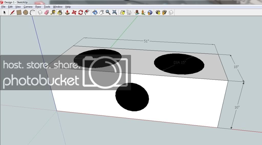

My problem is Even though I used a enclosure calculator I quickly realized that my enclosures have to be too small!
I inverted the subs and made the ports external, but still feel lacking.
Could someone help me design a ideal box.
I think i should build a single box instead of two and that my Volume was too small.

To continue with the above statement.
If I build a 8ft^3 enclosure for two subs with one port tuned to 34Hz.
use a 10" port = length of 15.57"
or 12" aero port = length of 24.18"
Anyone offer help or clarify if this is correct or something going wrong, thanks!
Can someone comment as to the above Design.
Should I go with a bigger box its 8.5 and subs/bracing I apprx .5 = 8
What size port should I go with?
Thanks!
