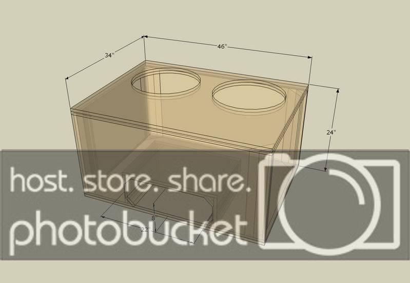

In a couple weeks I will be purchasing 2 brand new fully loaded 18" BTL's... or maybe even 9518's if they ever get on the market.. so for now, the BTL's.
I drive a mini van (1997 Mercury Villager).. poke fun if you'd like, but the chicks dig it! haha //content.invisioncic.com/y282845/emoticons/wink.gif.608e3ea05f1a9f98611af0861652f8fb.gif
Area I have to build the box in (while still keeping 1 row of seats and of course the driver/passenger captains chairs in):
Length: 42" (3.5')
Width: 46" (3.8333...')
Height: 24" (2')
*Those are all conservative dimensions, so no worries there*
Planned to have the subs up and slot port back.. probably some elebarote way to change out the port to test around, but I need to get the basic box built first.
I have over 26 cubic feet to work with, although Fi says 5-8 for each sub...
This is my daily driver, but would much rather have SPL than SQ, as long as I can still listen to music and understand it! lol
Any help would be appreciated! Thanks!
mmm.. heres a hugh box.... 16 cu/ft @ 33Hz w/ 170 sq/in port with plently for bracing and double baffle.
