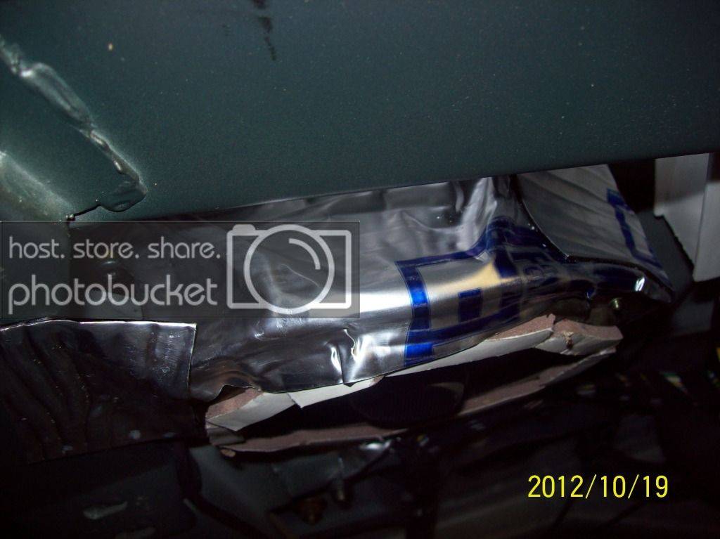

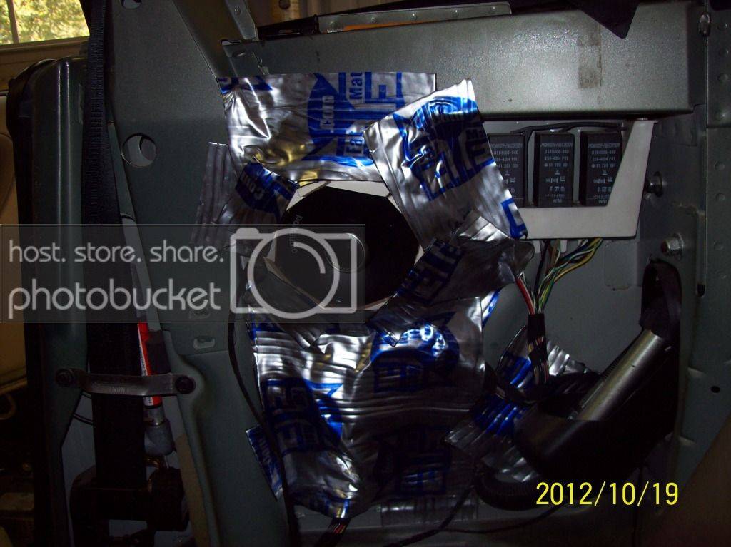

Here's what I do
That's roofing tin IIRC that I used. I used cardboard to trace out hole that I was going to cover and then traced it onto the tin and cut it out. Be sure to cut the tin slightly larger than the hole so you have a way to attach it. Then put a bead of silicone around the outer edges of the hole, press into place and drill a few holes around the outer border and install a few pop rivets to hold it into place. Works like a charm and is stiff and non-resonant after a layer of deadener.

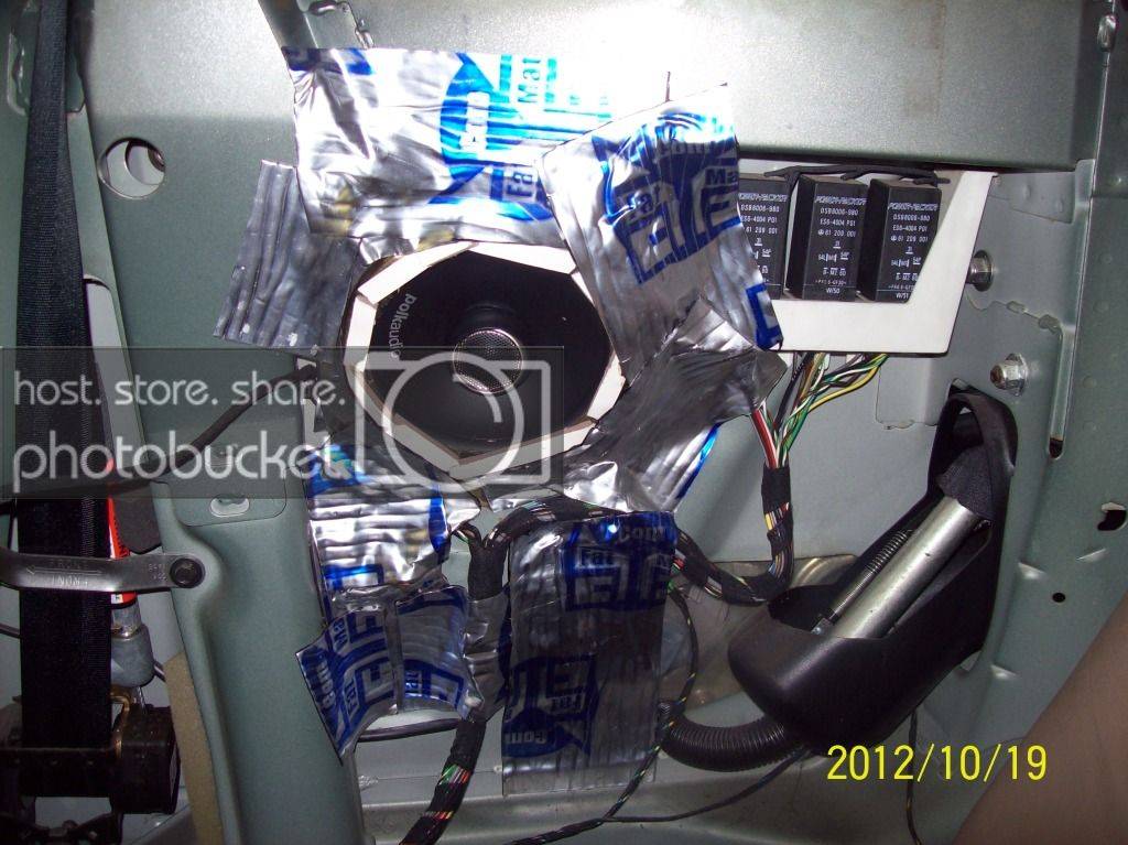

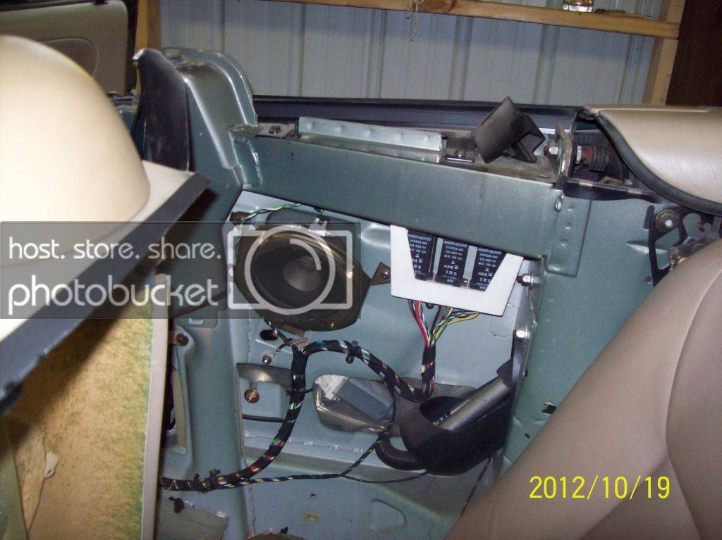

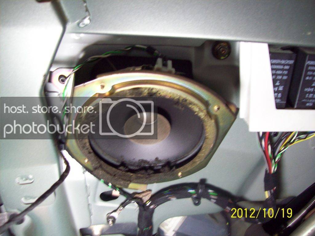

here is what I started with, very unsealed.
Much better response than being all open.
This was in the rear of my car but it is just the same for the doors.
