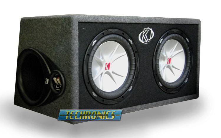

i just ordered the dual Kicker CVR12 pre-fab box (DCVR122) and i want to avoid blowing them once more.. so could anyone maybe give me insite to why my other one did blow?

i assumed the box was built to spec... its built by kicker specifically for the subs that come in it..

no those are prefab boxes which **** IMO. Get a custom built enclosure.

There is no reason to assume that enclosure sucks. Can you even give one solid reason why you assume it sucks?

To the OP: Almost everyone here (except audioholic) will agree that prefab boxes ****. If it's a sealed box, it doesn't matter so much, but with ported it usually turns out that it's either: A. Not big enough, B. Not enough port area, C. Tuning is way off, or D. All of the above. A Kicker prefab box, may be better since supposedly it's designed specifically for those subs. But the first box you had was not designed for any set of subs, it was just a generic prefab correct?
