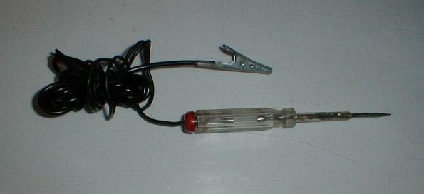

you need one of these

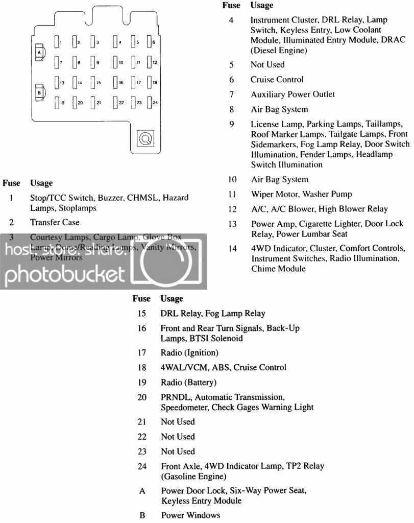

you also may not have a stock ignition wire in your car. try running your red wire to your wiper fuse on your fuse box. if your car doesnt have a stock ignition wire like mine, then your hu wont fire up because there is no wire there to power it up.

If the yellow constant 12v+ wire shows no power at the harness, you either have a bad fuse or a break in the wire on down the harness. You can use a fuse tap off of the radio fuse and run a new constant wire to the radio.

People who do anything electrical in a car without have a test light are making things so much harder than they really are.
