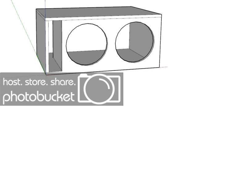

what about dual slot port?
do i just make them 1.75" wide
the reason for the dual slot is im going to make a front baffle to cover the box and flush mount the sub similar to this but with a mesh cut out for the area in front of the ports
