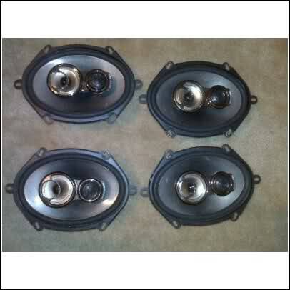

or.... ARE THESE FOUR WORTH $50???

No, I don't think the speakers you posted are worth $50. I hate coaxials...
