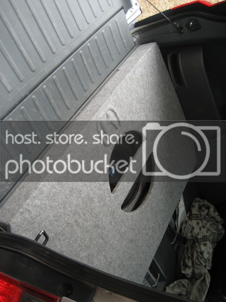

here's some pics of the box to give an idea of the shape
and here it is with the cover on. there is about 3 inches between the box and cover.
I would try ported. It will definitely improve the output of that sub. I owned one a while back.
