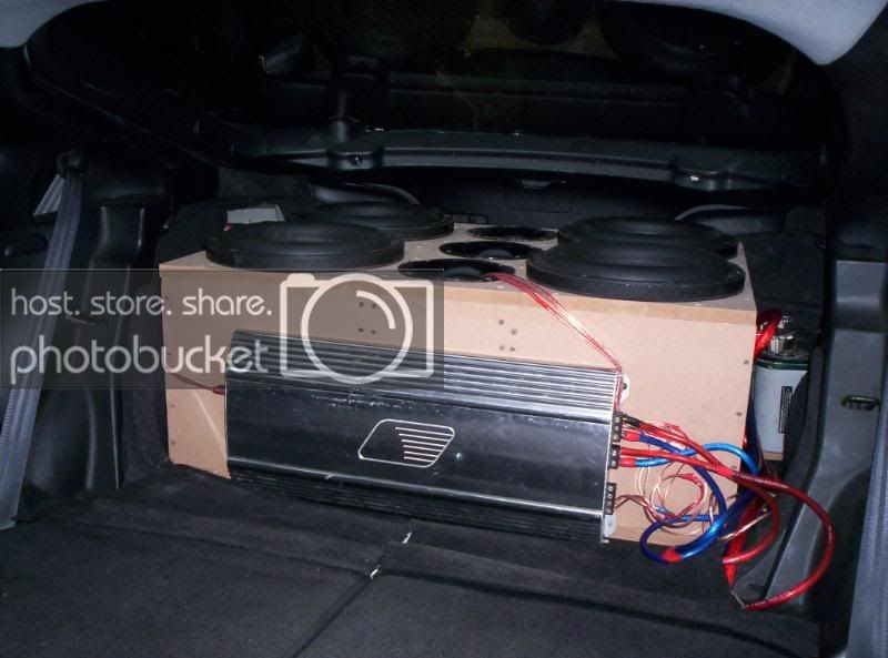

I just got back the four L7 12's I purchased off here for a friend a few months back and now I need to do a box design. I am trying to run this pig in street c for dbdrag and I traded my two Mojo quad 1 15's for them and I know I can burp just a hare under 150 with them and no testing and wrong port tuning etc (pulled the boxes out of my crx and threw them in the rsx, big peak freq difference)

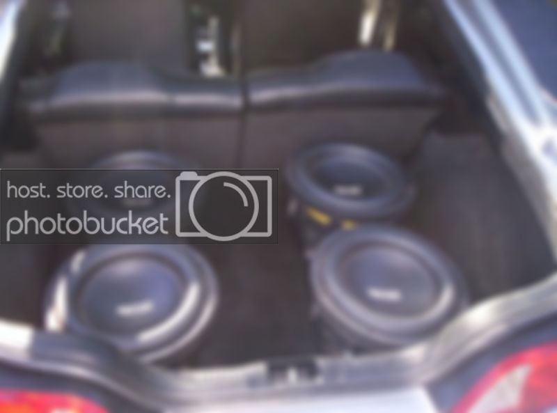

so I was going to try and do two separate boxes, sub firing forward and one firing up, or sub firing to the side and one firing up. so that would be two subs firing up and one firing left and one firing right (polarity flipped on one to keep them in phase). I know crx's can get loud doing multi directional sub firing, even though it goes against logic of cancellation and phase.
i dont have 25" deep to mount the four subs firing up and a port for the back, it just cant fit. So i THINK i can get 25" deep to put all 4 subs firing up, but i would have to do a port firing forward //content.invisioncic.com/y282845/emoticons/frown.gif.a3531fa0534503350665a1e957861287.gif...

man its not good, i've got 36-38 wide, 17-18 tall, and 25 wide and thats pushing it , may have to round off the front edge just to get my back seats up... i'd love to beat my personal best of a 157.1 on the TL usac style with the mojo's but thats a tall order, CRX ftw...

as far as peaking, me and a buddy each were @ 53hz in our RSX's...
my crx boxes are tuned to like 58 and i still peaked @ 53hz, i would like roughly 50sq in of port as well, 5-6 cubes is what i was told for burp boxes with four L7's.
i may try some boxes that do like i said, probably 20-21" deep, 17 tall and 16 wide each... two aero's per box for two 12's...

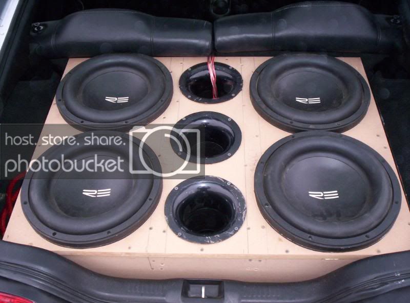

I already tried four RE MX 12's in my car
thrown in //content.invisioncic.com/y282845/emoticons/confused.gif.e820e0216602db4765798ac39d28caa9.gif
that setup dogged on the mic, like horrific, to the point I wont mention the # //content.invisioncic.com/y282845/emoticons/wink.gif.608e3ea05f1a9f98611af0861652f8fb.gif if I dont do 5-8db louder than it I will be quite unhappy...
