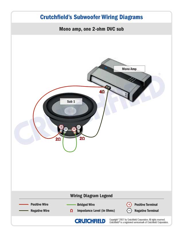

Which amp? Look @ this.

the diagram above is for serial wiring to RAISE the ohm load.
you want parallel.
wire both the + leads together and both the - leads together and connect them to the respective + and - terminals on the amp.
don't look at that, you don't want a 4ohm load...
but you're correct, wire positive to positive, negative to negative and then to your amp...
edit: djman beat me to it...
^don't look at that, you don't want a 4ohm load...

yes, wire all the +'s together and all the -'s together. However you get there is up to you, coil to coil to amp or each coil back to the amp. Just don't do any + to - anywhere.
