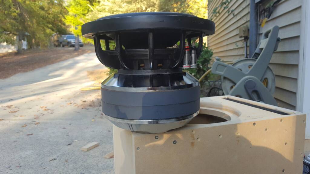

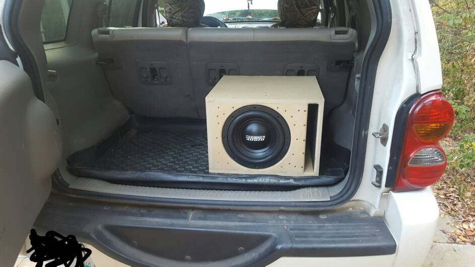

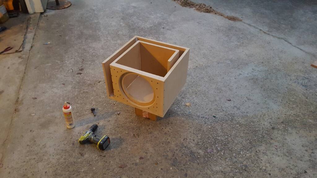

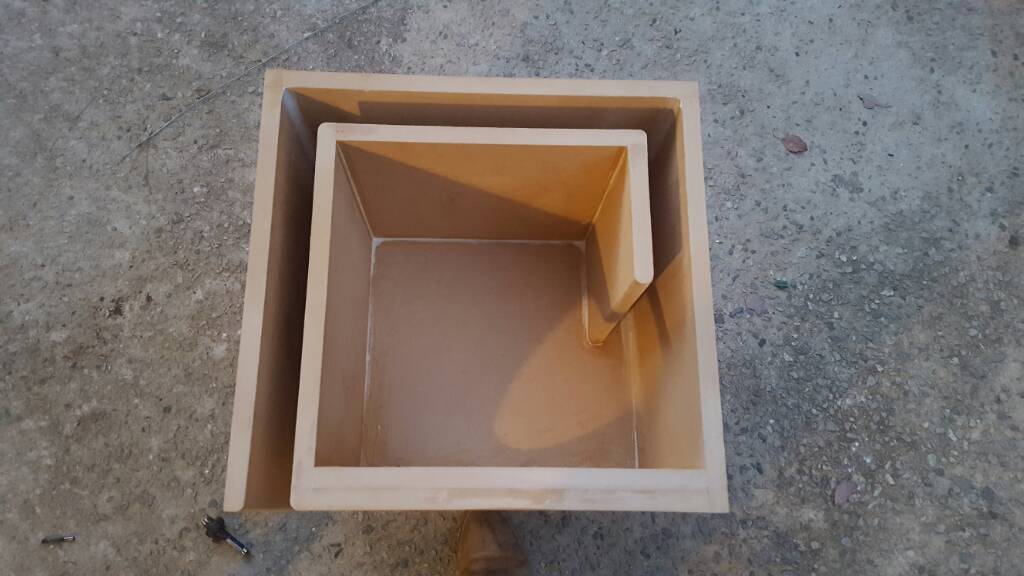

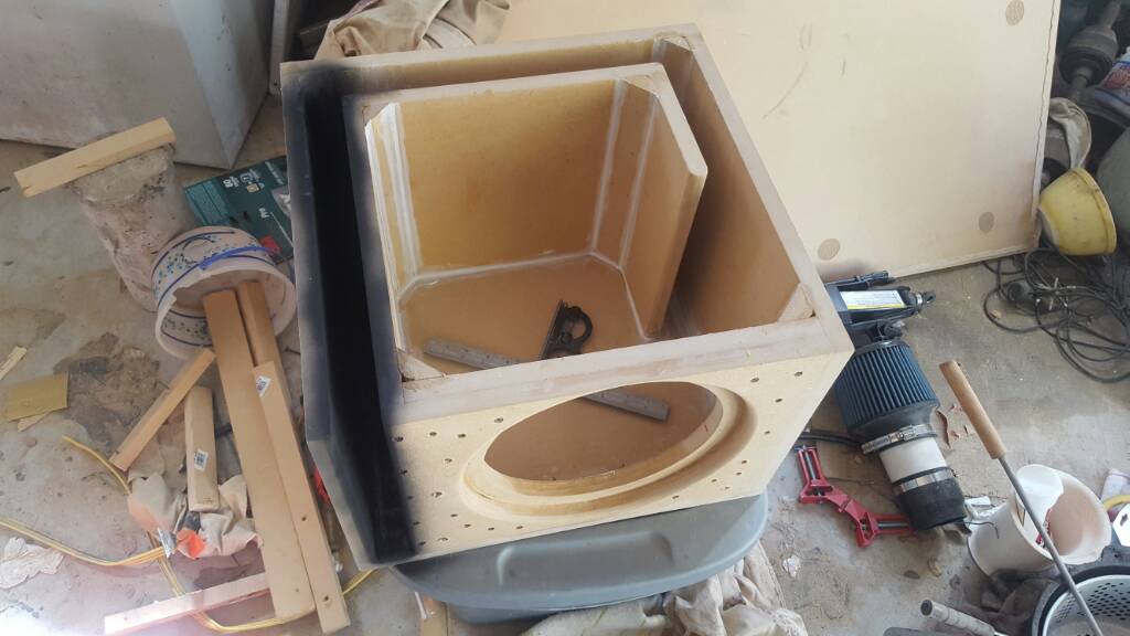

My laptop is out of commission so I don't have a way to do a sketchup, but here's a great design for it.
0.85cuft@31.95hz with 15.61sqin port per cube.
21" wide, 12.5" tall, 14" deep.
Port is 11" tall x 1.25 wide x 37.5" long
Box will have 3 port panels and it'll look similar to this.
Sent from my SM-G920T using Tapatalk
