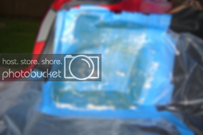

lay down some heavy duty plastic in the trunk and form the shape of the bottom of the trunk with layers of glass.then make a mdf ring to the demension you want the face to be.after that use scrape pieces to set the height and then use fleece to form around the sides to connect the glass tub to the md ring stapling to hold in place.then apply layers of glass to the INSIDE of the box.this makes the finish work much easier.
lay some blue tape where you want to glass. then put about 2-3 layers on to get a mold.
use a sharpie to trace where it needs to get cut back.
with the mold in the car use a piece of cardboard to make a template for the mdf.
once the mdf is cut just glass it to the mold.

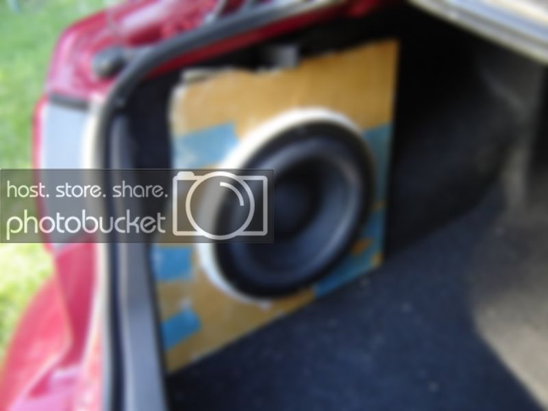

this was in a mazda6. right in the middle of the box there was a push clip in the carpet. i took it out a found a bolt to fit in it. the box does not move at all and cannot be taken out without taking the sub out first.
glassing is way easier than you think especially if your using mdf on the side you can see when its in the car.
