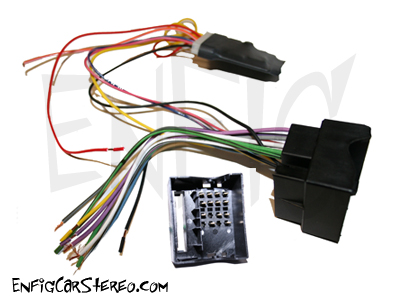

so whats happening is my headunit stays on and will not turn off. if i open the door when the motors off the unit stays on. i turn on the alarm the headunit stays on. Do i have something hooked up wrong my cd player won't turn off.
On the wiring harness(es) there is a wire that says; "Remote" or "Ignition Switch"
That's the signal that tells your unit to be on, or lets it turn off.
Do you have that wired to the correct lead?
diagram:
factory-wires[plug+][-plug]adapter harness[wiresplice]headunit harness[plug+][-plug]headunit
Probably screwed up in [wiresplice]
*edit: nice car, I was driving one last week. Loved it. Germans make kickass e-brakes.
your vw doesnt have a switched 12v back there both yellow are red are constant. the hu turns on by canbus. i used a switched 12v from the harness plugged into the tach side of your gauge cluster. or post 75 under the left side of the steering column. they both work but now i am gonna use a relay on the red wire and the 12v turn on from the tch harness...
