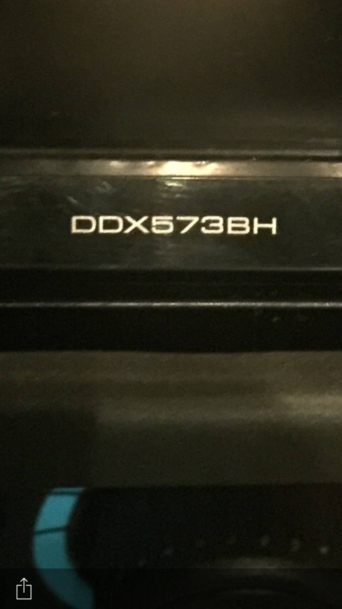

I've had my head unit installed for 8 months and this morning when I go to work I notice that the radio won't turn on. I pulled radio out after checking fixes and then saw that the fuse on the actual radio blown. What could have caused this thing to blow after so many months?? I will say that I tested the power and ground and am only getting 11 volts. Could that be doing it ?? It's a kenwood ddx-573bh
