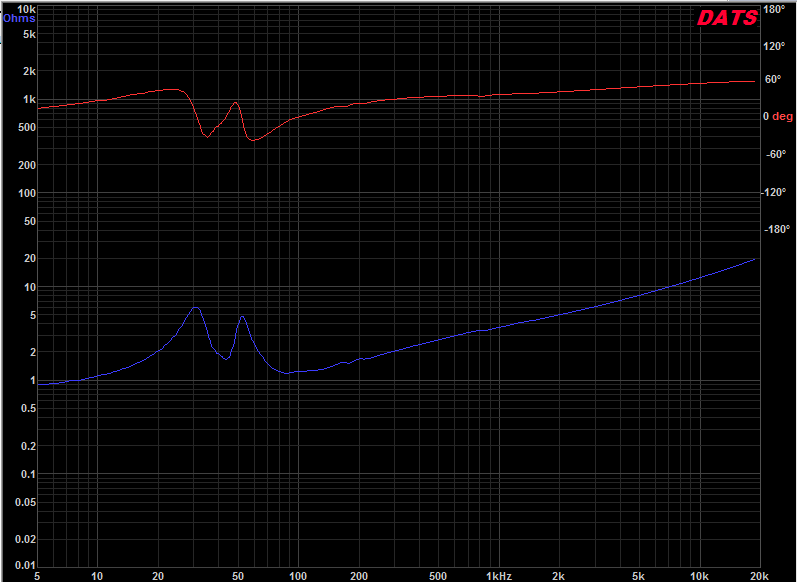

No it isn't and no it doesn't. For reference, z-max at Fs (47hz) is 6.25ohm free air, Z at 47hz in the box is 3.5 ohm and Z-max in the box is 6 ohm and at 30hz. Free air impedance at 30hz is 2.05 ohm.
It would be very poor practice to count on such generalizations if you were attempting to put yourself in a position where any of this is important. IF you really needed to know your impedance curve you must measure it in box in vehicle. This can be done with some graph paper or spreadsheet, tone generator, and DMM or O-scope or a tool such as Dayton DATS.

Free air there are not two peaks, there is one at Fs, then impedance will approach infinity as frequency raises due to the inductance of the coil. Z-max does mean the highest impedance, but that will not be the same frequency as Fs nor system resonance once it's in a box.
