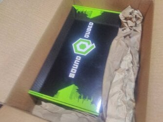

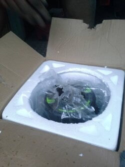

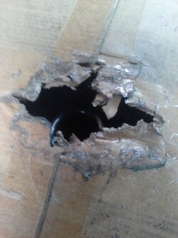

3)  Received shipment from Soundqubed Today.  One 10'' 600 rms dvc sub.  One S1-850 mono amp.  Great sub reviews from people who ran the sub hard for months, maybe years for one particular review, & great amp dyno results on youtube.   Sweet, right?  Not so fast...

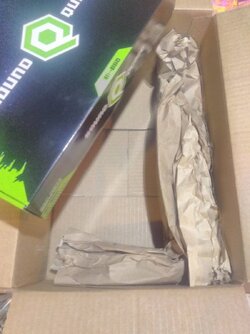

Sub packaging:  NO padding or protection on top (cone), and NO padding or protection on the bottom (magnet).  I pick up the package and wonder why it feels so saggy, look underneath and there is a gaping hole in the bottom of the box, the magnet is poking through, exposed to the great outdoors.  What - the - faaack.  Handed the box back to the FedEx guy and signed the refuse-to-accept form.
Amp packaging:  paper padding on only 2 of the 4 sides (D+ for effort?), no padding or protection on the bottom of the package.  Thin amp box (retail box with logos/imagery) to cardboard, that's it.  No visual signs of damage, but considering the entire bottom of the amp had no reasonable protection from the handling during shipping, internal electronics could have taken some beatings.. maybe leading to premature amp failure at some point?  I'd really like to know what you guys think about this one.  Would you return the amp too?  I'm pretty darned sure i'm going to.

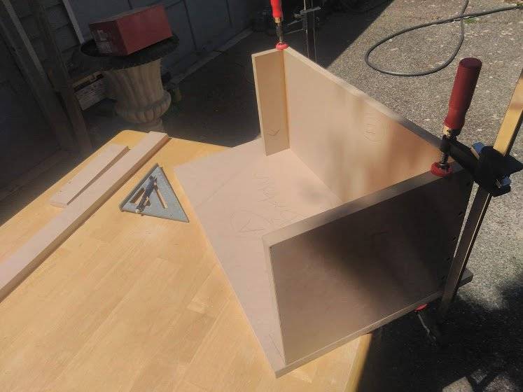

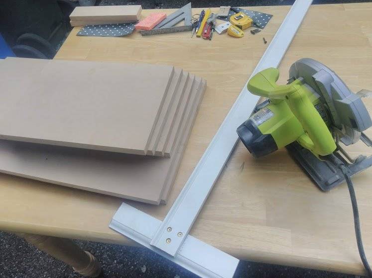

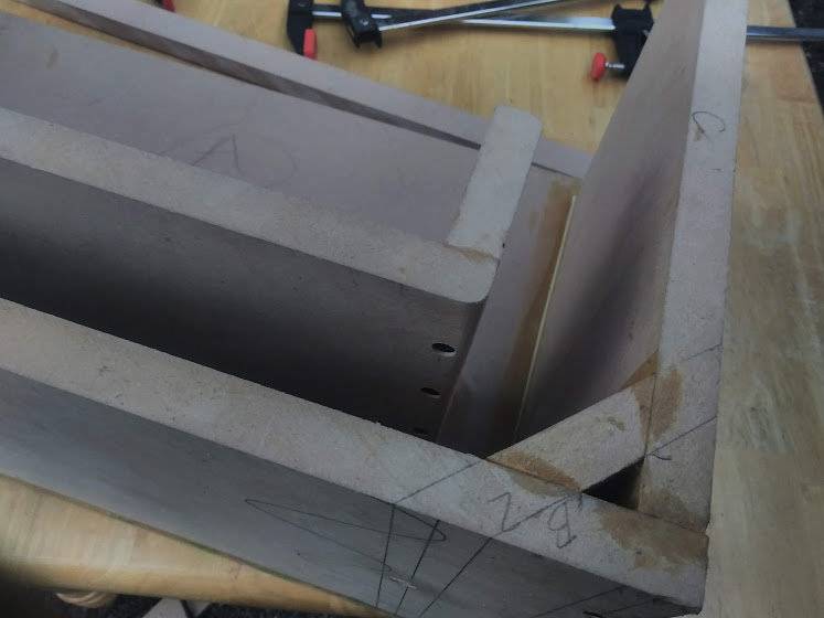

So I said before that I could handle building the enclosure (my framing experience and tree work skills led me to believe this, 0 finish carpentry experience!), but after a failed attempt today and wasting more material than I can afford, I could certainly benefit from some advice on the procedure.  I have my panels cut and am ready for assembly.  This is the design I'm working with, from Soundqubed:
No compressor or brad-nailer.  Do have pilot-countersink bit and screws but that was kind of a pain.  I've heard that you can just hand nail, and would like to go this route but I want to get a second opinion, and recommendation on nail style/size (working with 3/4 mdf).  And if you recommend I stick with screws, what size?  Soundqubed said #8 screw @ 2 1/4'', but that seems huge, no?
My biggest headache is figuring out the stages of assembly.  Someone recommended separating the port assembly from the sides, and to begin with attaching the sides to the bottom.  If you look at the design that I'm using and are a NOOB like me, then that doesn't seem to straight-forward.
Would you consider (B) (B) and (C) the sides, even though one of the B's is the Sub face? And would that make (D) (E) and (F) the 'port assembly'?
I'm pretty unsure about how to fit the interior portions of this enclosure; which piece to install and when.
Attaching the sides to the bottom is pretty simple; just keep rotating the piece so that you are screwing or nailing into a piece that is standing vertically, on edge.  But how would you stabilize the interior portions while assembling, considering the box will be sitting on the back or sub face at that point, and the port pieces would be hanging horizontally in said configuration?  Totally stumped.
Thanks for any advice you guys may have to offer!
I pre-mark (spacing/port width... etc) and pre-drill all parts where needed... then i'd assemble the side panel/assembled portwall 1st. I personally use #6 coarse thread drywall screws 1 5/8" long for single .75" materials.
Just take your time and use plenty of woodglue. Bar clamps can come in handy when assembling.
Copy.  1 5/8 is what I was thinking, thanks for the confirmation.
I use 1 1/4” deck screws. Glue the **** out of it, and clamp it as much as you can. I put 1 screw about 2” from each corner, and that’s it. The glue will be stronger than the wood once it’s dry, so no need to screw the crap out of it.

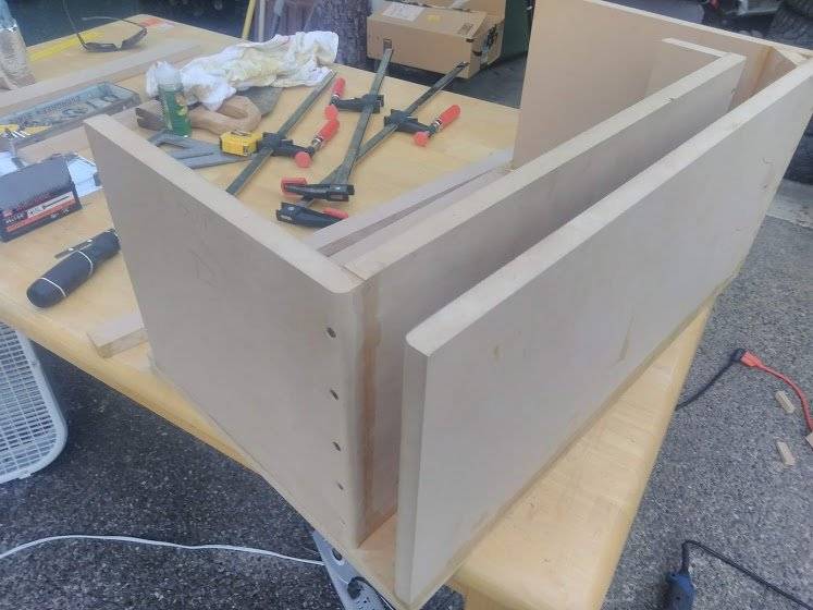

Update.. First enclosure is going pretty alright.  I actually i'm pretty damn happy with it.
Bought four clamps, as advised, used them all.  Used a few more screws than I think you vets would have.  Everything sits flush on the base; for the lid a couple things are off a heavy-32nd, so will sand a little before the top goes on.  It all seems to have a great seal, and I even hand sanded some bullnose on 3 of the port edges.
All of this has been done with a circular saw and a corded drill, so with that, super happy with it.  Waiting to get the sub to verify cut out before attaching the face and top.
Does anybody think I need a brace of sorts near the sub?
Thanks again!
