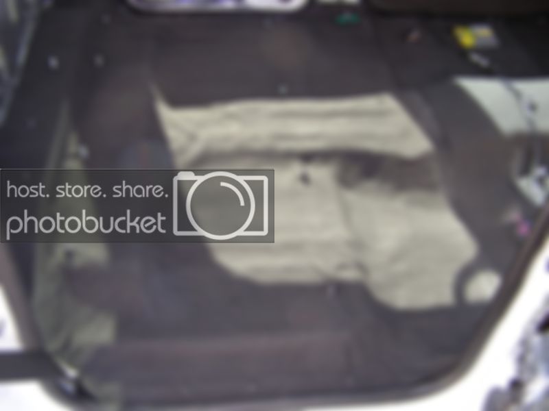

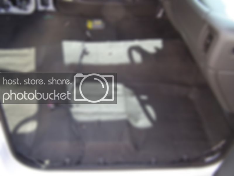

Two layers of ensolite on the floor. This stuff makes a big difference in keeping the road noise to a minimum. I noticed a huge difference between having 1 layer and having two. I am tempted to do a third while I wait on the Mass Loaded Vinyl.

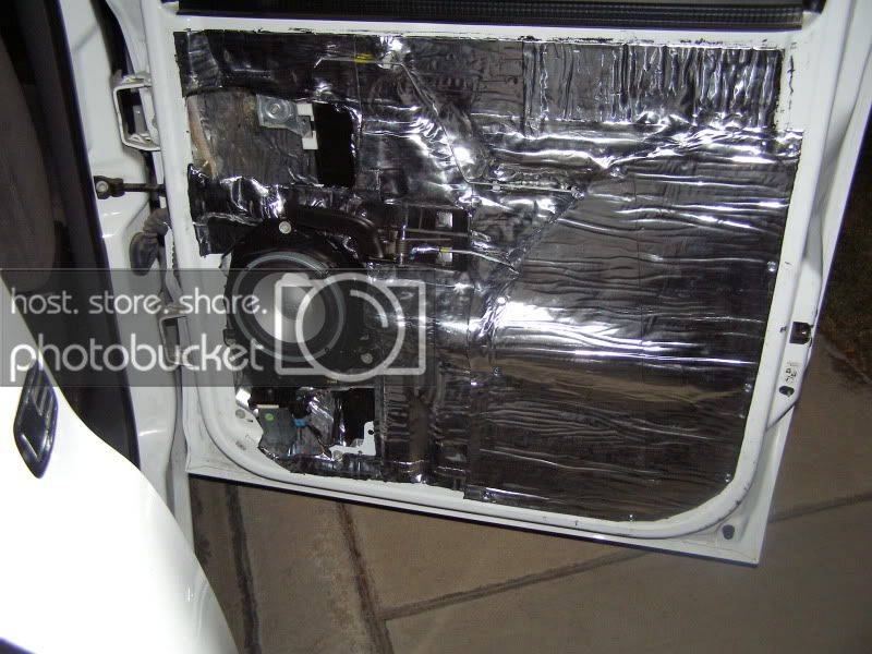

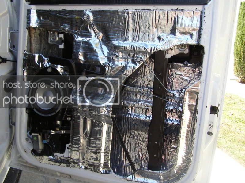

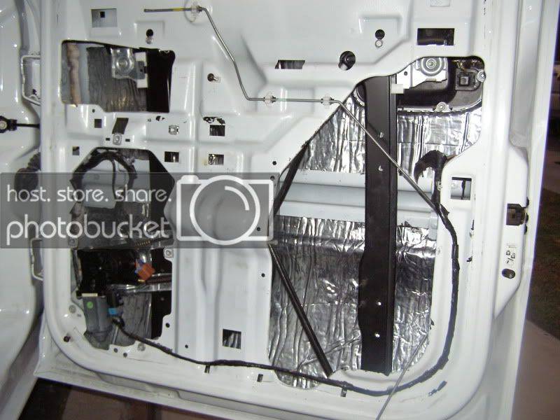

Also did some work on the rear doors since I carry lots of friends who would probably like to hear the tunes as well.
Previously I put down two layers of raamat to the outer door skin and 1 layer to the inner door skin.

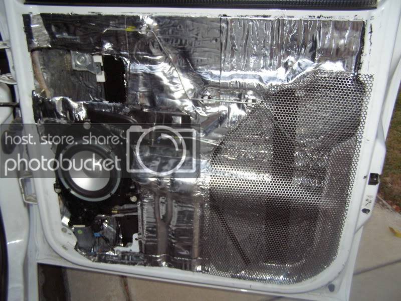

And I started covering over the large holes with perforated aluminum.
Then covered the perforated aluminum on both side with raamat.

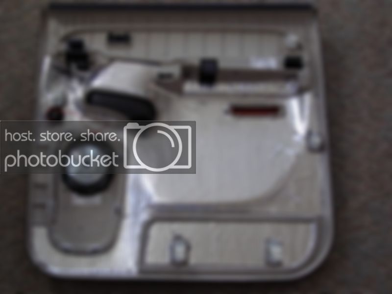

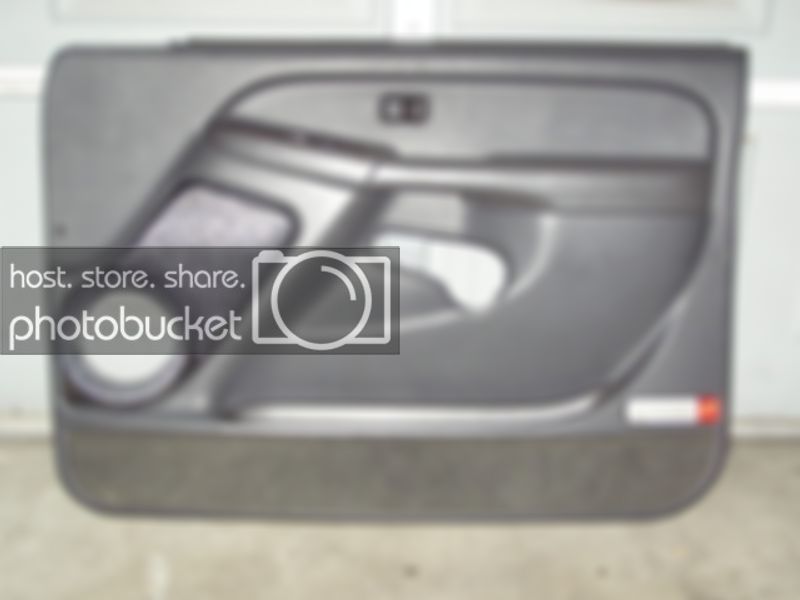

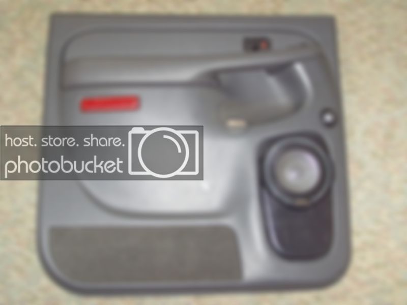

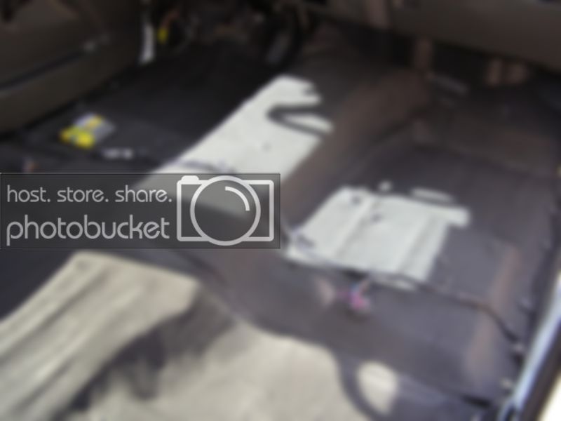

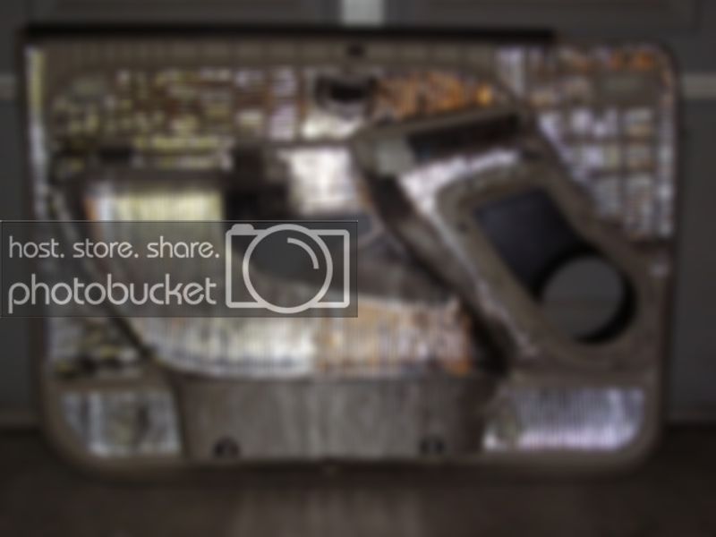

Well I added a layer of MLV and put on the new carpet. The added thickness made it a real pain trying to get the seats back in. Also got to work on the front door panels. I had extra scraps of butyl so thought I'd put them to use before I cover the panel with ensolite.
Also added the speaker pods to the panel. I bought the molds and added a mdf ring and glassed it in to strengthen it up a bit for the hertz midbass.
