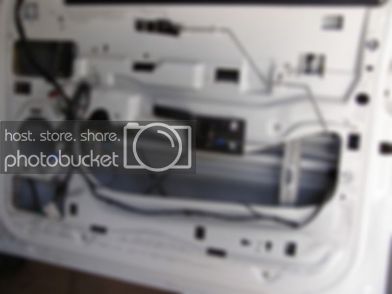

What I started with...

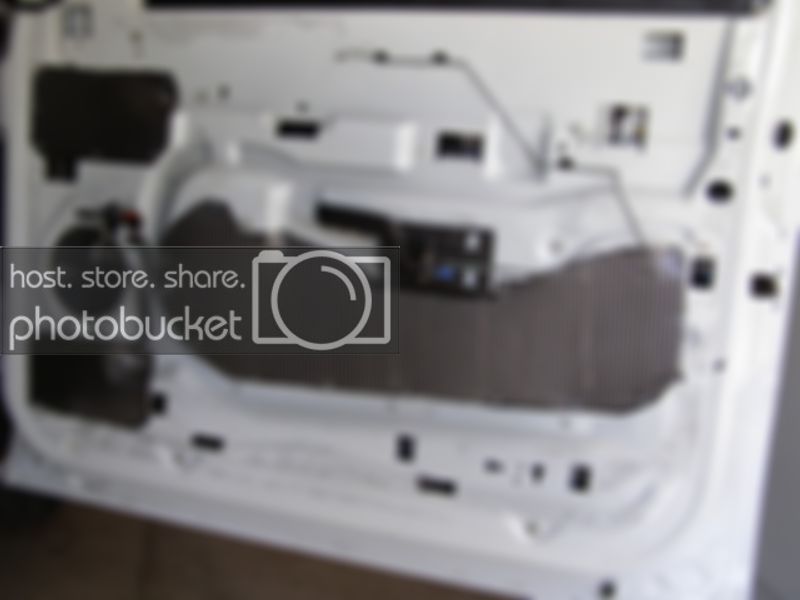

Midway through...

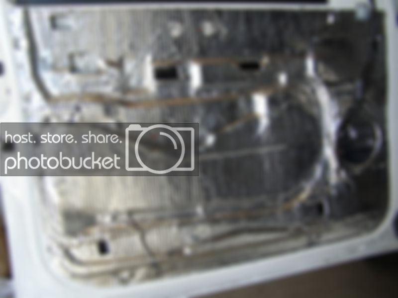

Finished with Raamat
2 layers on the outside and 1+ layer on the inside. Next comes the ensolite. Made a huge difference as I can feel cabin pressure go up when I shut the doors. There is 60 square feet in both doors. Pounding on the door skin I can feel air coming out through the holes where the interior door panel attaches. Can't wait to see how the Hertz components sound.

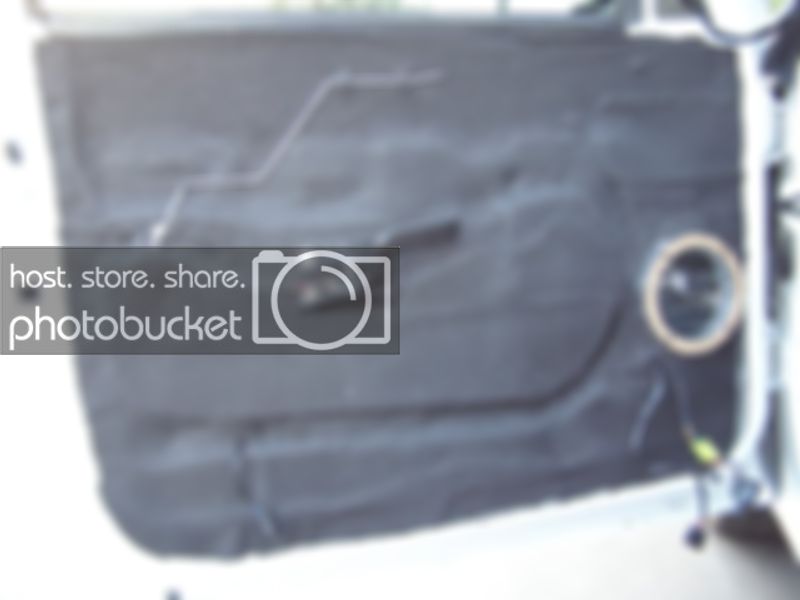

Added a layer of ensolite and some mdf rings.
