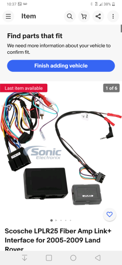

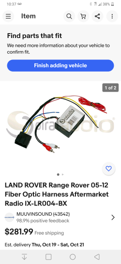

Have you browsed eBay? Screenshot_20231014-223758.pngScreenshot_20231014-223748.png
As for which signal to use, I tried all combinations and getting signal from the dash and front & rear doors is the only way the system sounded...
