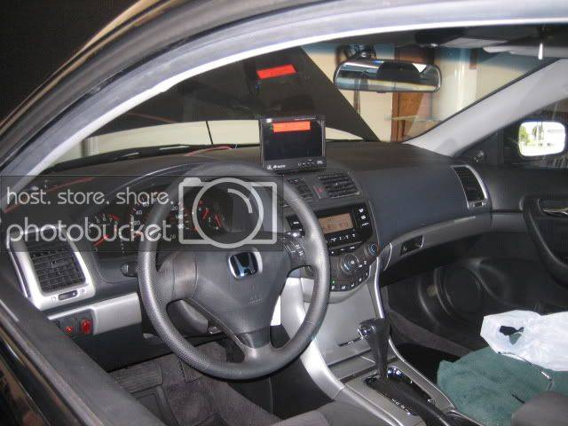

Ok here is the situation, I have been using the Pyle Half-din monitor and fabricating it into a certain piece in my accord (pictured/video below) its the Pyle PLTV7.5DIN. I know its pyle, but it is the only half din flip out I can find. I love it because it is the perfect size for my application. As of 2 weeks ago, they have DISCONTINUED:furious: them, Anyhow I need to know if anyone KNOWS if there is any other Half-Din flip out monitors, it is crucial!, thanks alot guys!

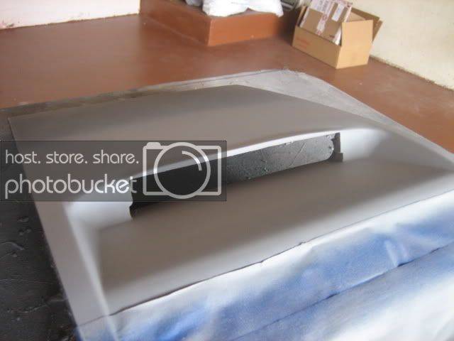

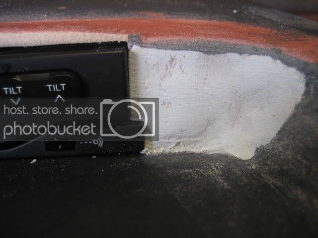

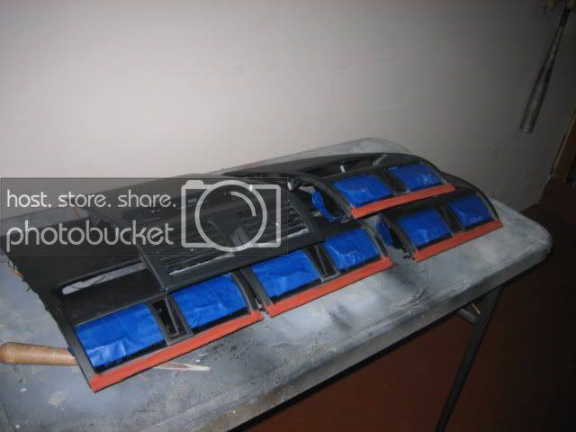

yea. here's some very very brief pics of the process, you can see in the last pic, I have 4 pieces ready, but no screens.

how do you hold them in place? and are you gonna start fabricating them and selling them? and how did you wire it for sound, but it looks real good, did you just use bondo for it?
The pyle screen comes with brackets, which I build up in the back with 2 nuts on either side, and I CA Glue them to the underside of the panel, and then Plastic Weld them for extra strength. I used bondo (rage gold) in some areas to get it smooth, but for the bezel, I used self hardening clay, .25 block wood on top (sanded down) and then Painted with SEM OEM Texture and Paint.I was on a roll selling them, I started back in October and just In Decemember I perfected it, and had sold about 7 and had 4 on the way as you can see, until I found out their is no half din flip out screen anymore. //content.invisioncic.com/y282845/emoticons/mad.gif.c18f003ab0ef8a0d9c27ca78d77a6392.gif
