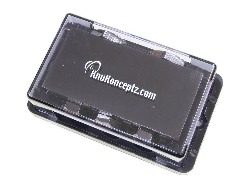

I have a Knu Konceptz grounding block that has (2) 0 gauge inputs, and like (3) 4-8 gauge inputs. One 0 gauge is going to the chasis, the other 0 is going to my 2nd battery. I use the other 4-8 gauge to go to my accessories. So the distro block is grounded to the car and the 2nd battery at the same time feeding my shit in the trunk. It may be overkill, but works out fine for me.
