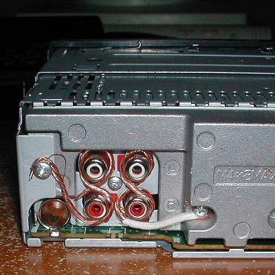

in would try wrapping bare wire around the rca'son the radio and grounding that to the chassis of the radio. also running a separate ground for the head unit to the chassis and not grounding it to the harness anymore.

Kenwood doesn't have the same situation as Pioneer. i would just measure continuity between the RCA shield and HU chassis before i started grounding outputs. Applying a fix for Pioneer on other makes could result in damage.
simply use your DMM to measure resistance between RCA shields and chassis. if you get less than .5 ohms, then no need to wrap wire around the shield. measure before action. //content.invisioncic.com/y282845/emoticons/smile.gif.1ebc41e1811405b213edfc4622c41e27.gif
