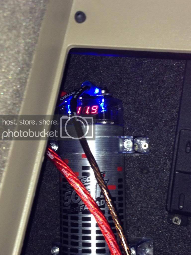

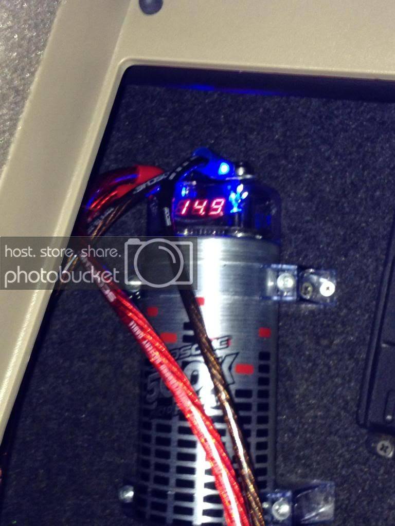

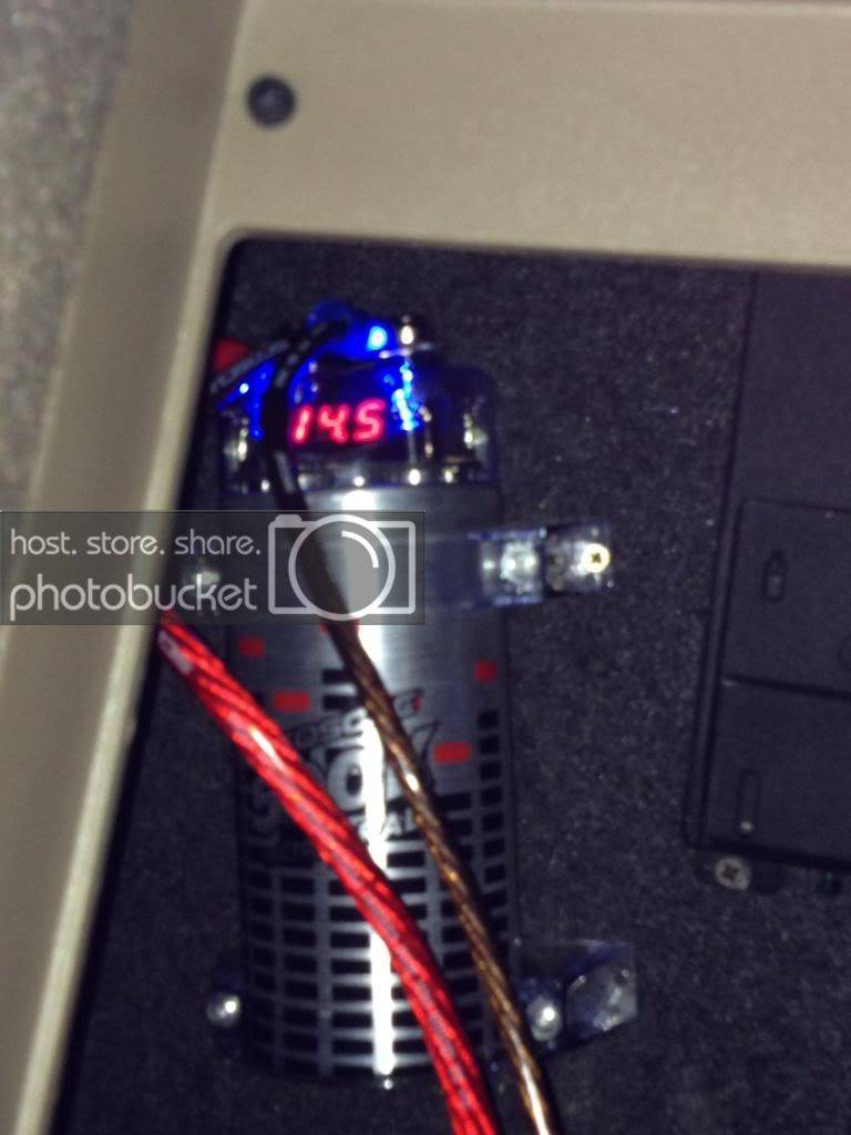

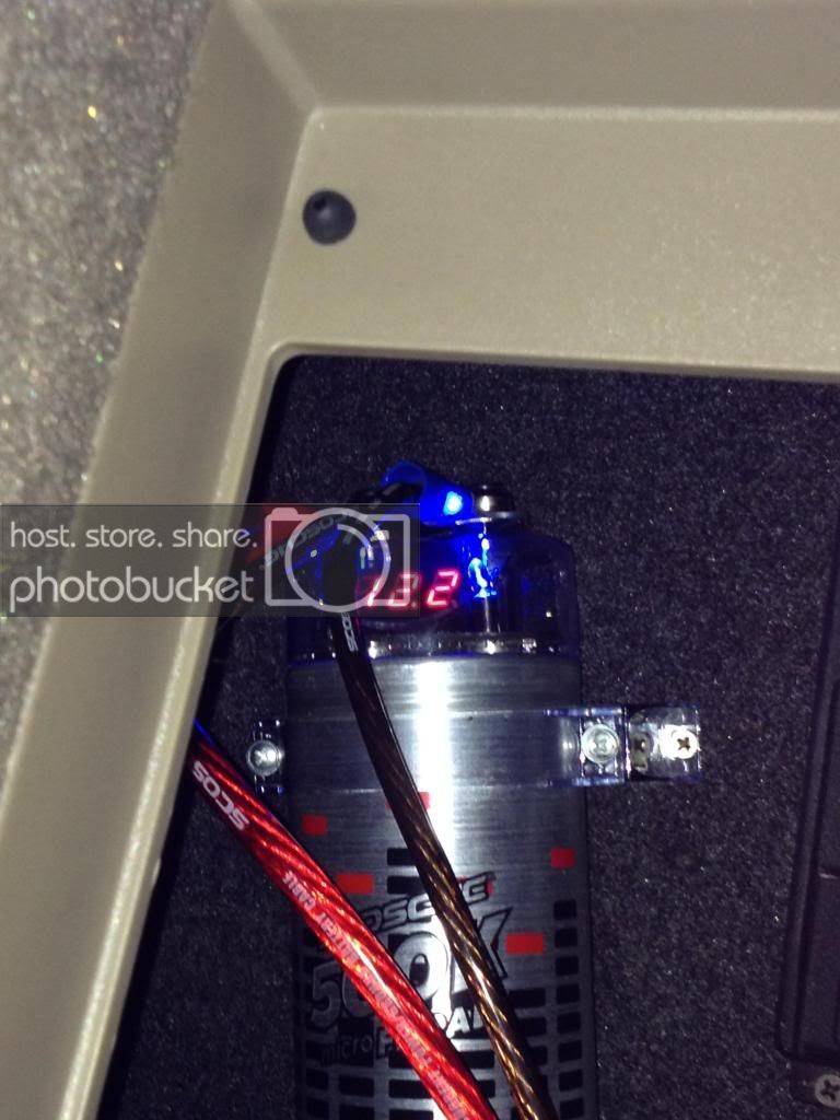

hmm... So even with no music playing, the cap still showed 12.4 or so, or it drops to 12.4? im curious to how your voltage is with out any bass
Driver door open, keys are not in ignition

Car fully on
Music at volume 15
With drops at 18 vol. went as low as 14.2

Bc I am an idiot at heart. I never had turned the car on when saying its idle voltage...I wasnt sure if 2.5volts was a huge difference so i just settled with the motor off numbers. Sorry bout that.
