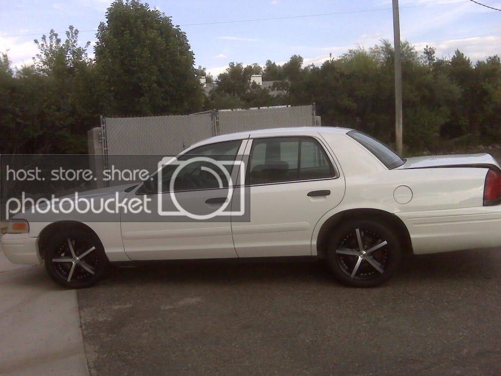

Here's what we got to work with.
Nothing to special.

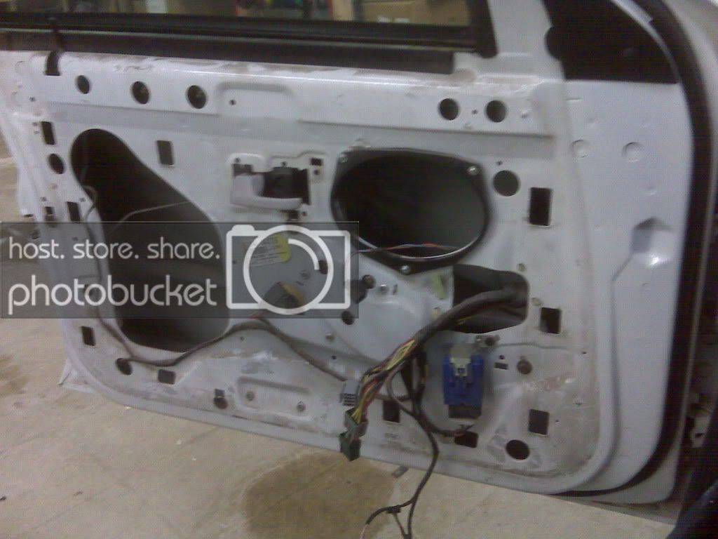

Door panels, dont you just hate the Ford 6x8's?

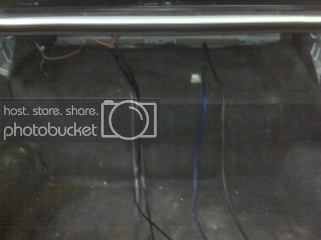

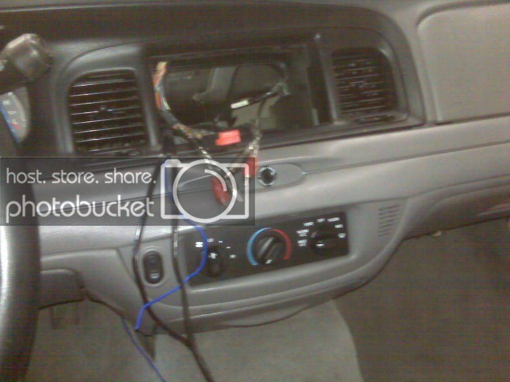

Ran some wires for the amps
More wires.

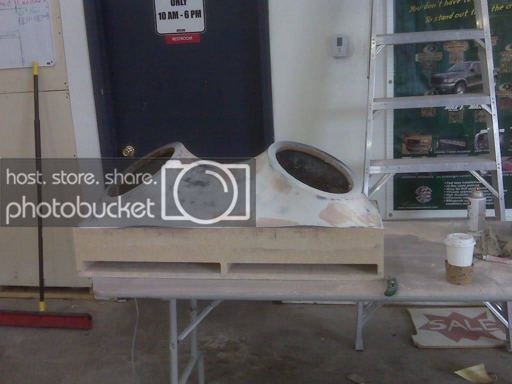

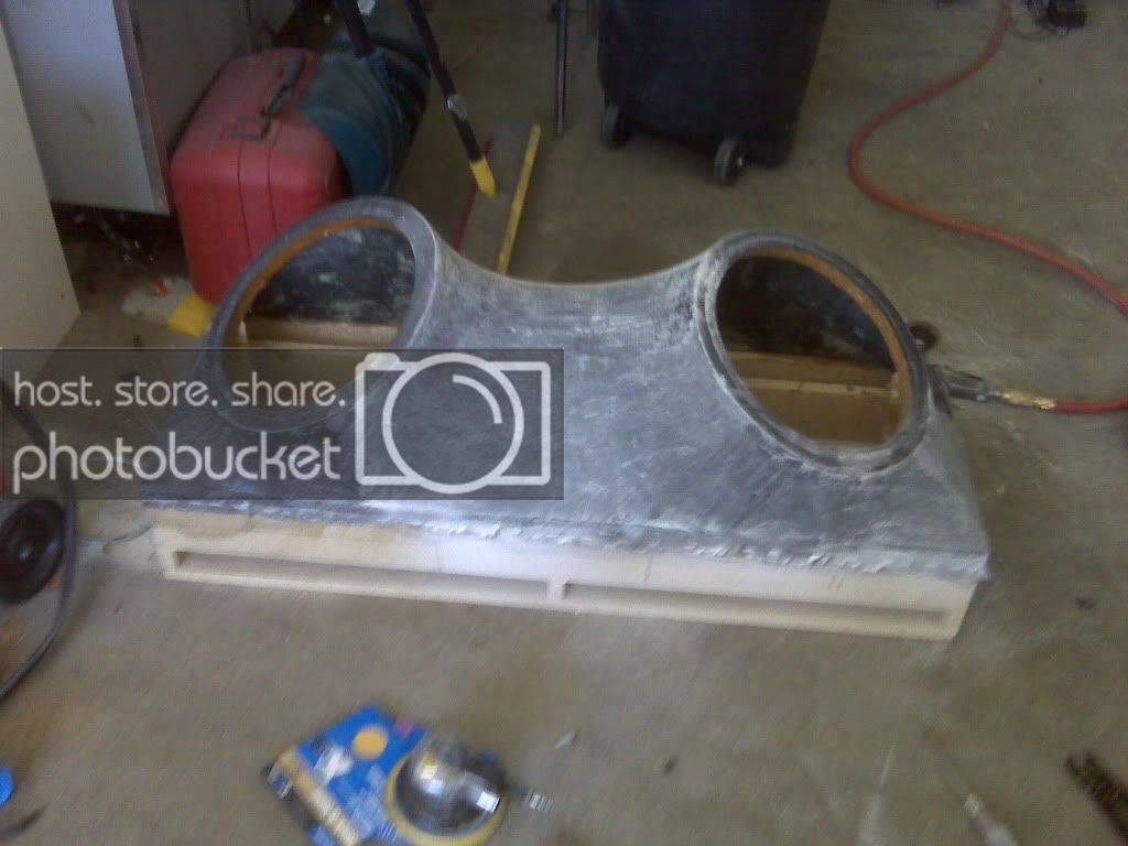

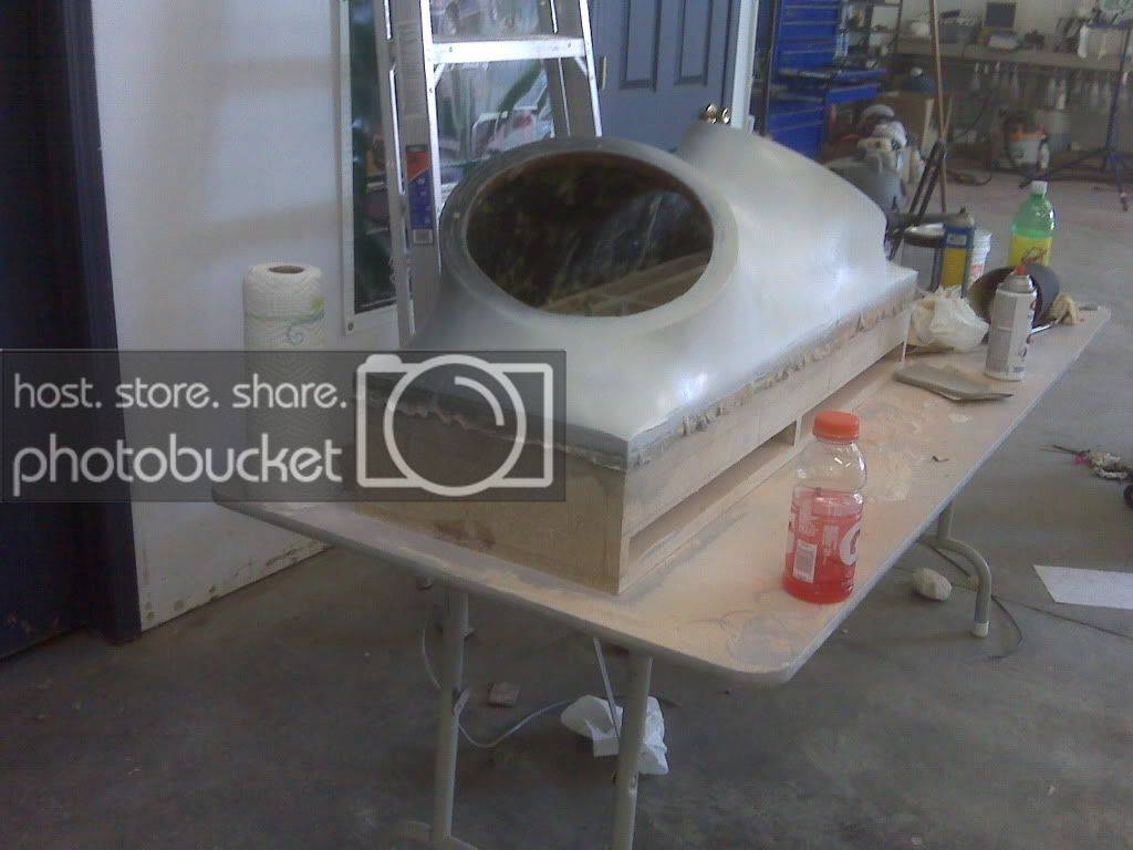

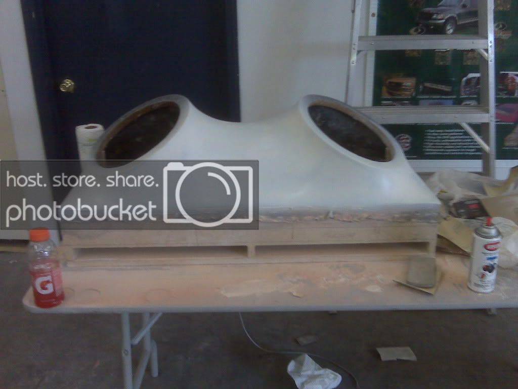

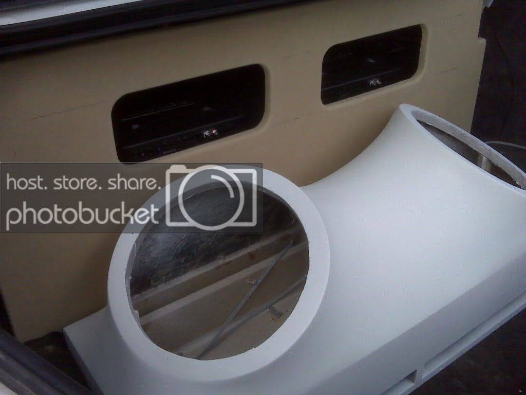

The box will hold two 12" MTX 55's ported.
Framework
Wettin in out.
Sorry no glassing pics, we did all the glass work on the inside to keep the flow of the box as nice as possible.
Test fitting.
Roughing it up for some body filler
Couple coats of filler, gettin all the highs and lows even.
Threw on some white paint to see how its going to look.

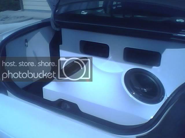

Finished up the box, now onto the rest of the trunk.
Added some side panels and painted it all up to match the box.
We might end up getting some plexi here soon and possibly etching in the amp windows with our Logo.

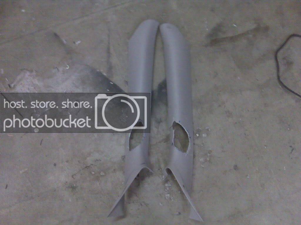

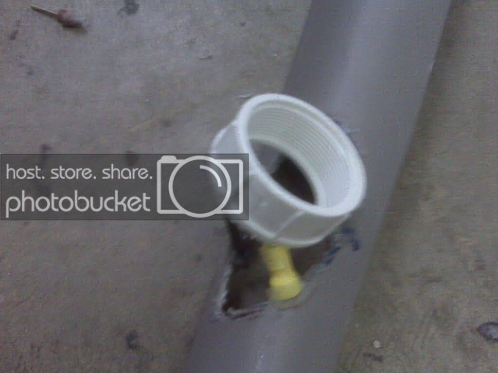

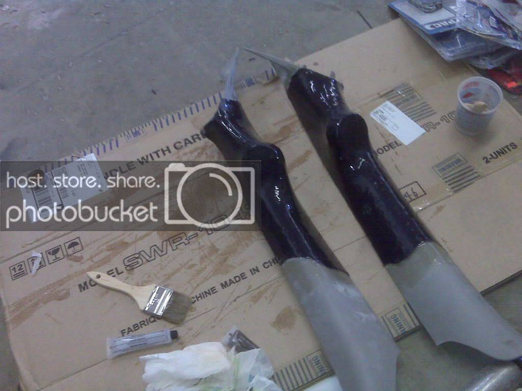

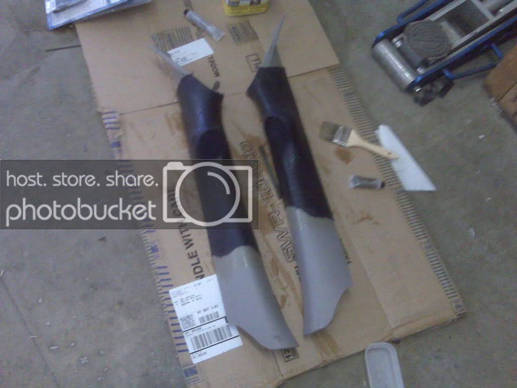

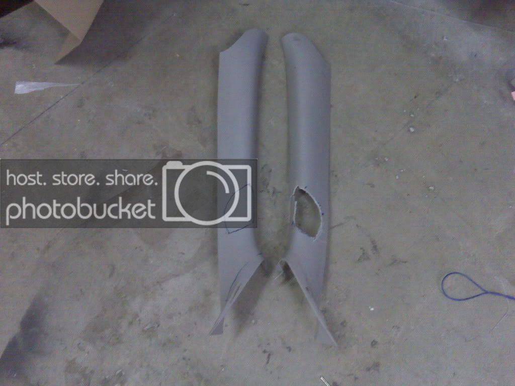

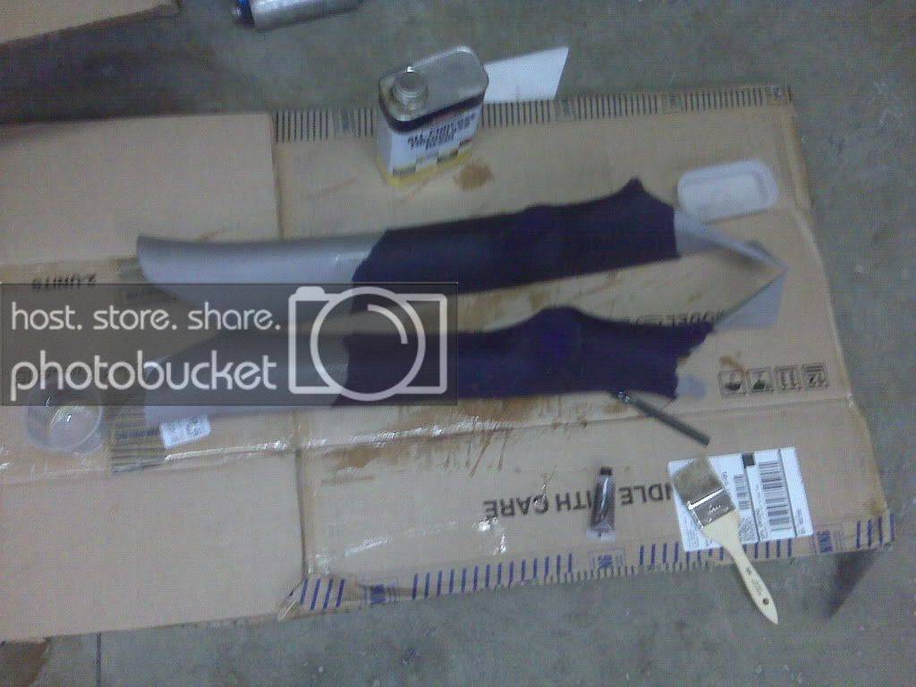

Now onto some tweeter pods in the pillars
The drivers side already had a hole in it from the cop search light
Just matched em' up

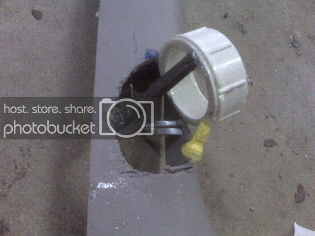

Got some PVC collars to fit in the tweets

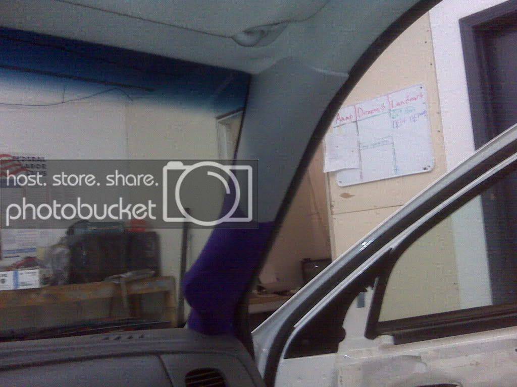

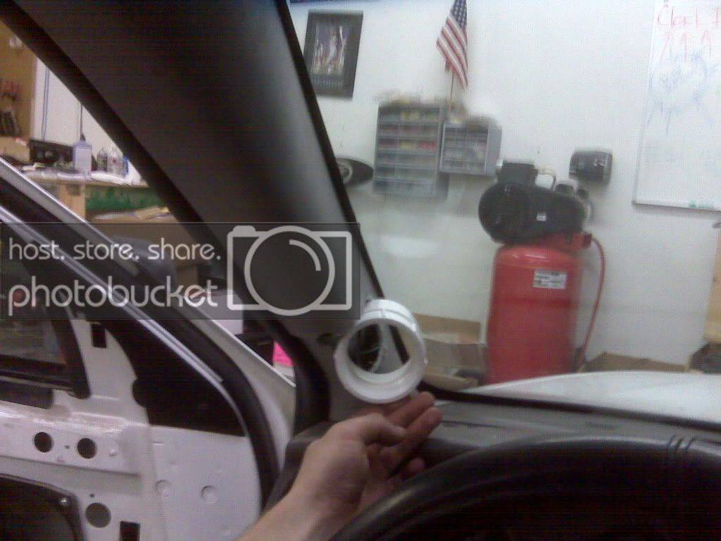

Figuring out positioning

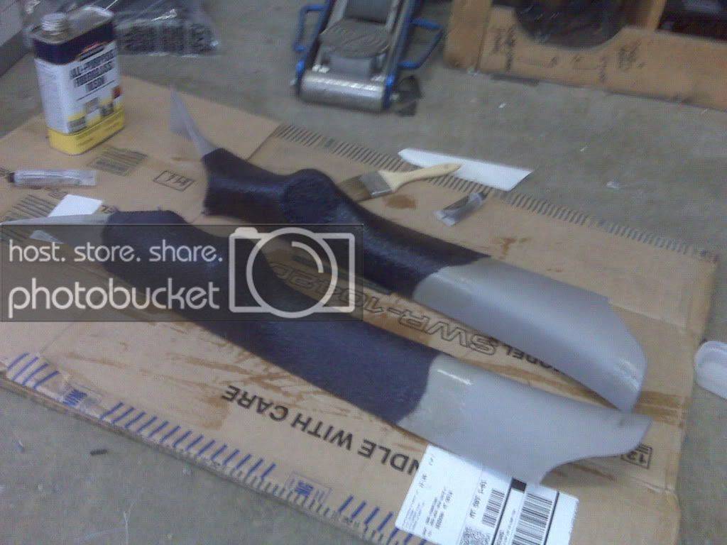

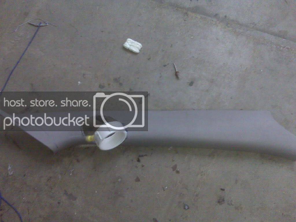

Stretched it with some fleece
Making sure everything lines up nice
Wet out with some resin
Sanded out and decided to give it a few more layers of resin
Well that's all i have for now, check back by for more updates.

Terminals are just personal preference really. And I'm coving the tweets with grey vinyl to match the car
How do you go about finding the volume and tuning of that box? I've always wondered. I know with a sealed glass enclosure it's not as big of a deal. Or with aero-ports, you can atleast remove and tweak to get the tuning. Curious how you went about finding the internal volume and end tuning. Looks good though.
wheels look ugly as fuk
Yea they were donated to us, really didnt have a choice //content.invisioncic.com/y282845/emoticons/crap.gif.7f4dd41e3e9b23fbd170a1ee6f65cecc.gif
with slot ports you have to somewhat guess at first then you fill it with packaging peanuts after you throw on the fleece and figure out its volume and what its tuned at and if it isnt a decent tuning you have to extend the sub rings out more/less depending how you want it tuned.
What tweeters are you putting in your a-pillars?
JVC Arsenal 6 1/2 components
