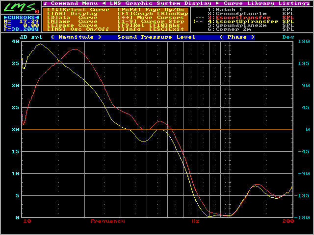

In a vehicle it is much easier. You have a lot of extra cabin gain to work with meaning you need a lot less power and displacement. This Escort for example has around 35dB of cabin gain at 10Hz with all windows up:
It doesn't take a lot to hit some high levels at 10Hz with that kind of gain.

Yeah, it is much easier in a car. Home audio guys struggle with huge boxes and long ports to bring sub 30hz up to the same reference level as the rest of the music. It's not uncommon to see tuning in the 15hz range for HT setups. In a small car you can tune to 30hz and still get an F3 at 20hz. Imagine what tuning at 20hz would do.
