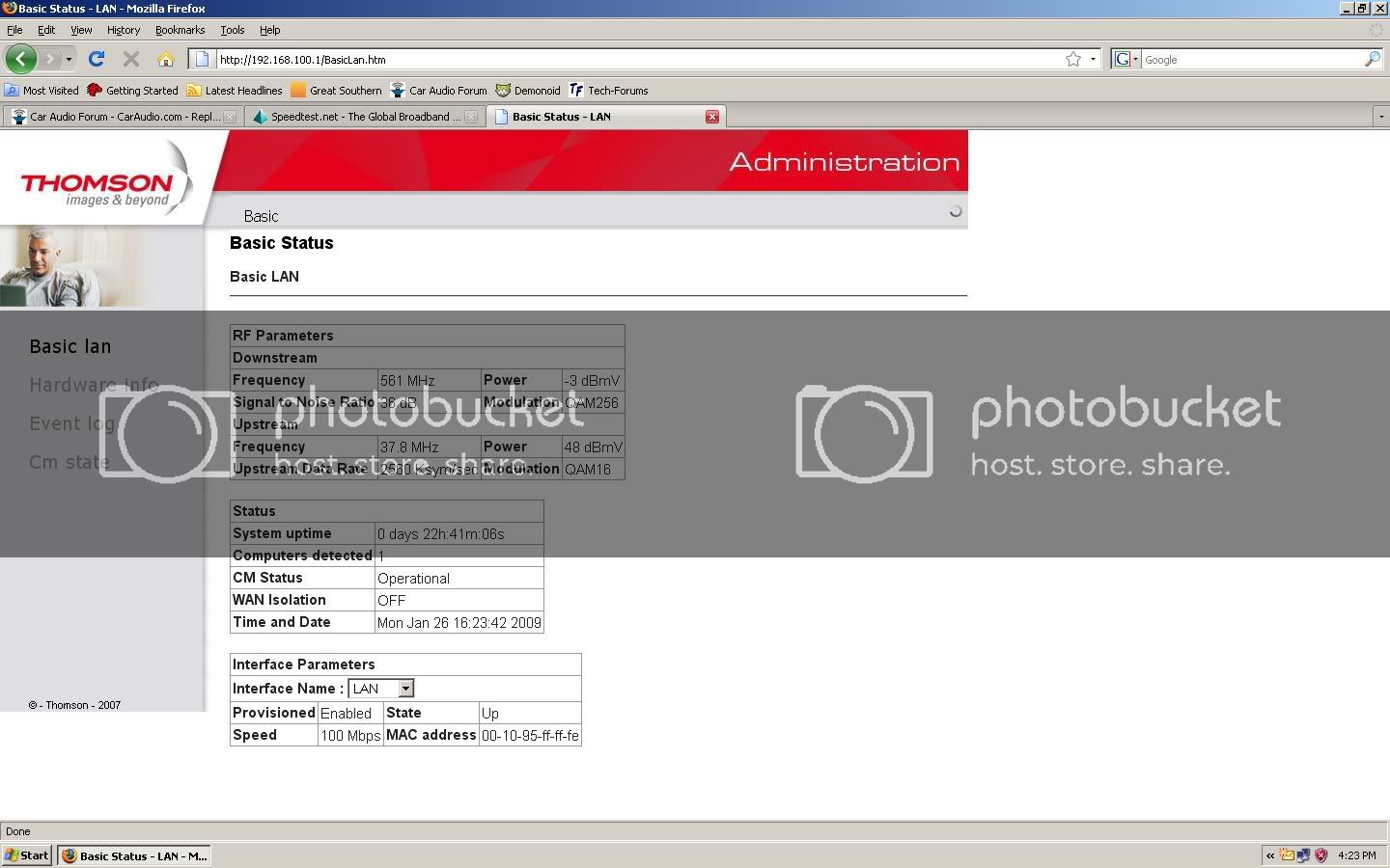

-5db splitter would be a balanced 3-way.
As for the modem, didn't they recall the 535s a few months ago? that's the flat RCA (Thompson) modem. Grey and white.
If I were the tech, I would compare those readings from the modem to the readings from my meter by running DOCSIS. Sometimes that modem is lying to you, especially if its going bad.
that would typically be a -5.5, -5.5, -5.5
Exactly.
Also if you look at the page he posted, his last reset was 16 hours ago. That modem is not holding its connection. There has to be something wrong in those lines. His numbers look good, but without knowing his configuration and the value of the tap, there is no way we can tell if his signal is clean. Especially that upstream.
By the looks of the numbers though, if everything is clean, I would assume he is on a 23v4p tap.

I actually reset the modem on accident. It came unplugged and the batteries died. The modem is/does hold it's signal.
It's starting to slow down quite a bit, so here it is starting out. It's not nearly as bad as it usually is, but it just turned 4:30.

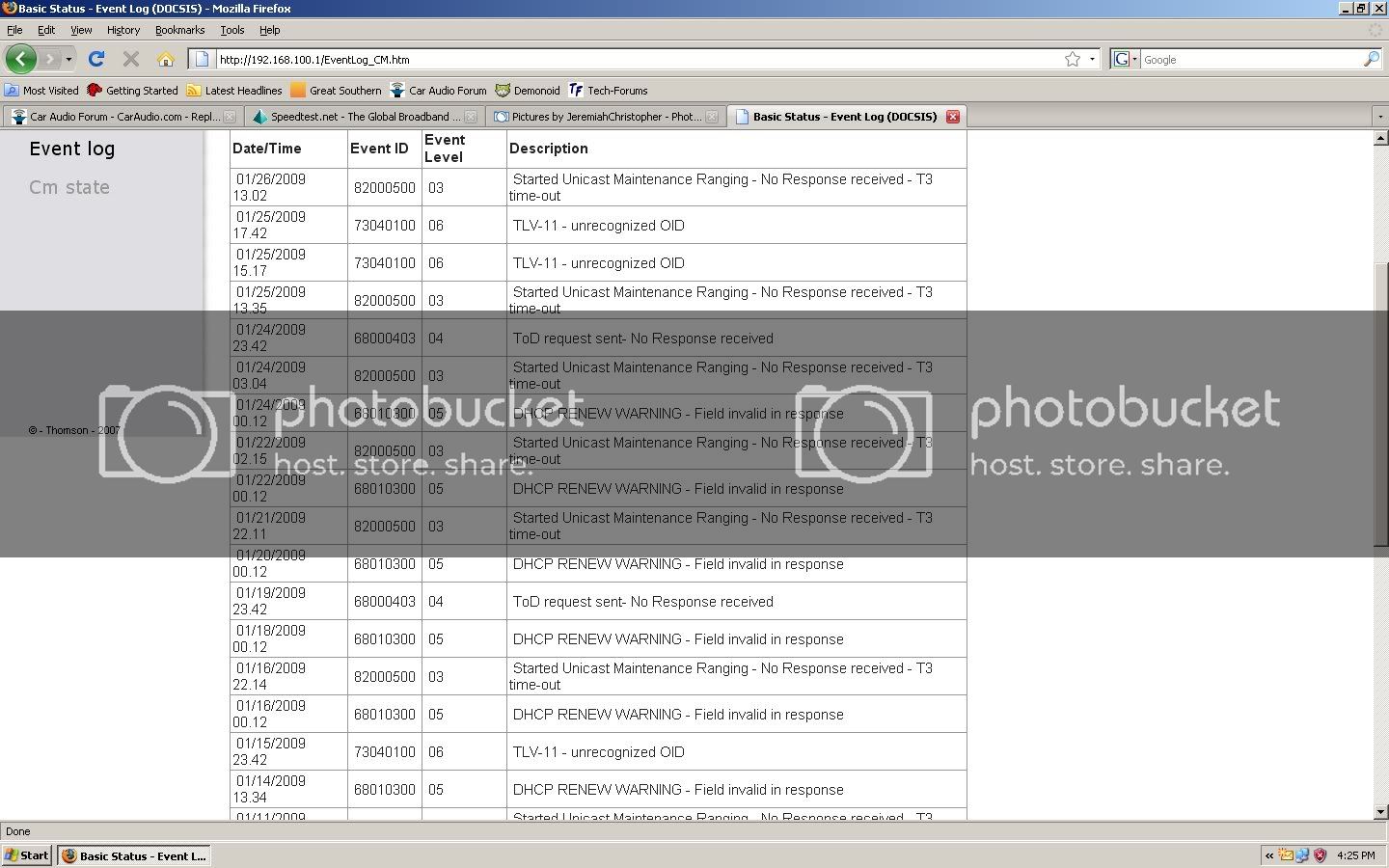

This is the event log, don't know if it could be useful or not.
