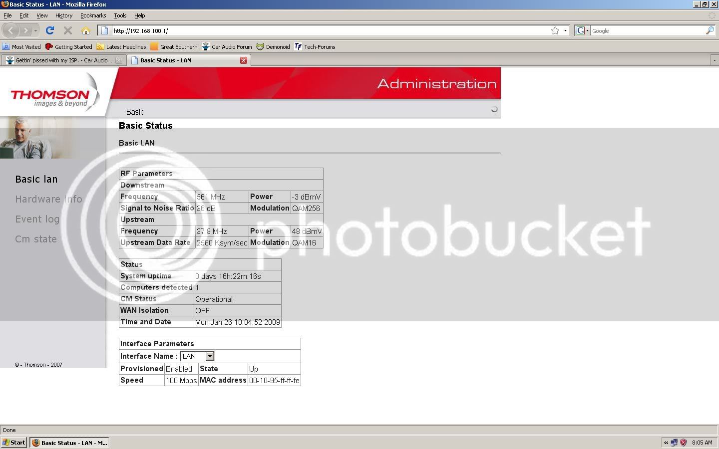

Notice the ping.
All is fine.

signal is perfectly fine
when the tech comes ask him to run a throughput test with his meter.
-3 over 48 with an SNR of 36 is just about as good as it gets....
