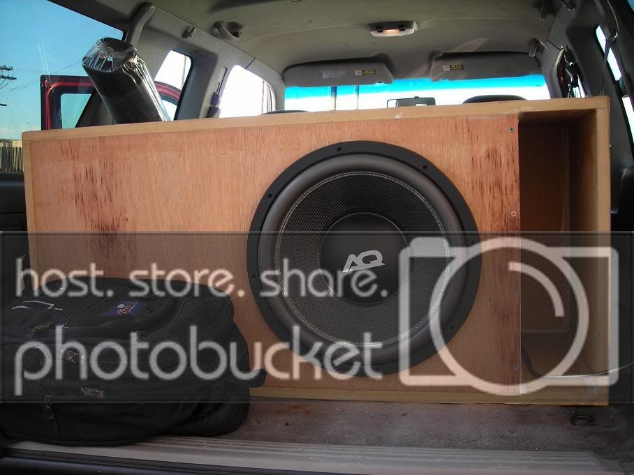

ok. well i listened to it some more today, and im having some issues.

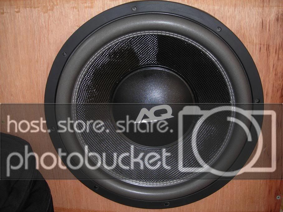

1) the woofer claims 3" usable throw. im assuming this mean, without bottoming out. well 3" = 76.2mm. cut it in half, and you get 38.1mm one way. my BTL was rated at 26mm of xmax. i cannot get this woofer to move nearly as far as my btl without introducing a not so pleasant mechanical noise. it almost sounds like a very light bottoming out (not the full on slapping sound). only thing i could compare it to would be like this:
but imagine it spinning at the speed of the excursion, if that makes any **** sense lol. i dont know whether its a loading issue with the enclosure or what. maybe the woofer just has a super tight gap, and its just the coil rubbing against the gap. i really dont know. im not completely familar with trying to diagnose subwoofer sounds lol. the btl has a similar sound, but it was much less noticeable. this noise is only really noticible when you pop the hatch and are looking at the sub from 2' away, but i can replicate it and hear it up front if i really push on it.
currently on even less gain on the kx2500.1, i can only turn it to 60/80 (depending on song, some i can go higher, around the 64 range) before i get the noise, while the btl would take it all the way up to 70 (where the gain is set for) and not really show any signs (mechanical noise would be there but very light).
although i cant move the sub nearly as much without it starting to sound bad, at the current level its on, it gets louder than the btl on the upper notes. in the current box, the btl was not very good at producing the upper freq's, it was a low end monster though. the hdc15's low end is not nearly as bad as people say. at least not in the 4.5^3ft @ 33hz its in right now. im honestly surprised with it considering its FS. im assuming it will pick up even more as it breaks in.
i will be building another box sometime soon with a different orientation. sub up, port back, as well as making the box deeper, to give more room for the motor and basket assembly. currently the motor is about 7" from the second port wall. that should be enough, but it never hurts to try something else.
heres some pics and videos. the sound that the woofer is making is inaudible in the videos and is covered up by my rattling panels, and bumper
. i will try to get a better video of the noise that it makes another time. btw, photobucket FUCKED the videos up. if anyone knows a place that can link videos like photobucket does, but NOT compress them as shittily as they do, please let me know so i can reup them.

and btw, what do you think of the noise issue im having? you think it might be related to the woofers orientation in the box near the port wall? maybe not enough room for the pole vent?

The Box recommended by DJ for my 12 inch hdc3 is 2.5 cubes at 35 or 36hz.
Your running 4 cubes at 33 hz you may wanna try a lil smaller box at 34 or 35 hz like maybe around 3.5 cubes. This is just a guess you may wanna ask DJ for specs for a 15 inch.
The Box recommended by DJ for my 12 inch hdc3 is 2.5 cubes at 35 or 36hz.Your running 4 cubes at 33 hz you may wanna try a lil smaller box at 34 or 35 hz like maybe around 3.5 cubes. This is just a guess you may wanna ask DJ for specs for a 15 inch.
specs on the site are 4.5 @ 40hz. im sitting at 4.5 @ 33hz. seems my issue would be even worse when trying to play under tuning (especially with such a high tuning) like AQ says the HDC3 is designed to do.
Audioque subs have been designed to extract max performance from moderate box volumes. The 8" subs work in 1.0cuft, 10-inch subs work in 1.5cuft, 12-inch subs work in 2.5cuft, and 15-inch subs work in 4.5cuft. Use these box volumes in multiples to calculate larger usable box volumes.
Hmmm.... no out of box pics? Just wanna see it. Maybe see if you can free air it on low volumes and see what the noise is? But yea opening the trunk or hatch or whatever is bad for the sub //content.invisioncic.com/y282845/emoticons/smile.gif.1ebc41e1811405b213edfc4622c41e27.gif
Also isnt that tuned a lil low for it? i though the old hd's loved 40hz? I dunno. nice little update.
well the low tuning should actually give it more cone control where it sees the most play in my vehicle. thats whats kinda catching me off guard.
i only free aired it on a low volume just to make sure the sub functioned and there was no mechanical noise that might indicated a build quality problem.
i will probably end up free airing it again, and see what it does. i just hate taking the sub in and out, because the wood can only take so much before it starts to strip out. i need to buy some hurricane nuts and bolts.
i stole the idea on the box from nG. he told me his btl liked 90^2 of port (i had a fully loaded 15" btl in this before which is why i built this box. this box was not designed for the HDC15 but rather the sub was just dropped in, to get a baseline). i would have to measure it out since i dont have my original design on paper, but i believe mine is around the 80^2 area. a little large, by most peoples standards.
I say take it down to the 50-60 sq. in. range, 3.5-4 cubes. Thats a lot of port area for a daily driver.
Or if you want to get fancy you could try 3 4" aeroports. //content.invisioncic.com/y282845/emoticons/smile.gif.1ebc41e1811405b213edfc4622c41e27.gif
yea i was gonna scale the box down to 3.8-4 cubes @ 36hz ( i just cant bring myself to tune to 40hz even though AQ suggests it) //content.invisioncic.com/y282845/emoticons/crap.gif.7f4dd41e3e9b23fbd170a1ee6f65cecc.gif. however i wasnt going to scale down the port area. that will be something i will try on this next box for sure. you know your DD subs, and considering the similarities between the HD series subs and some DD subs, i think i will take your advice. unfortunatly i cant really afford the aeros right now //content.invisioncic.com/y282845/emoticons/frown.gif.a3531fa0534503350665a1e957861287.gif
