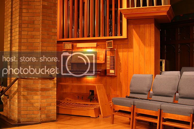

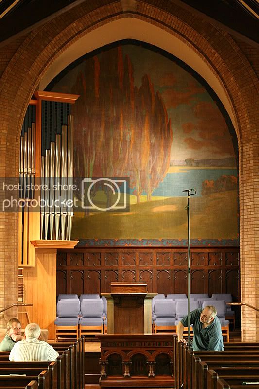

Here are some pics:
The organ:

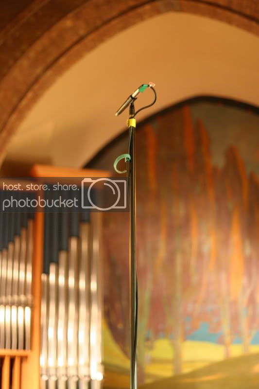

The mic's:

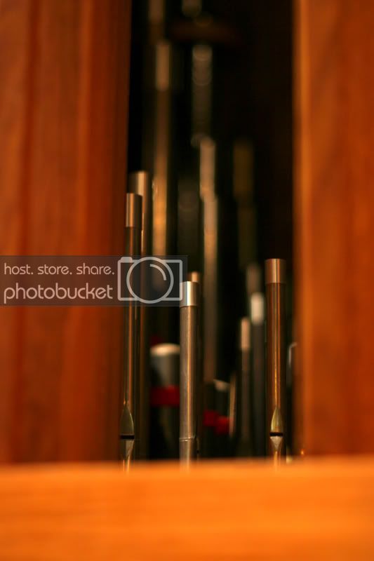

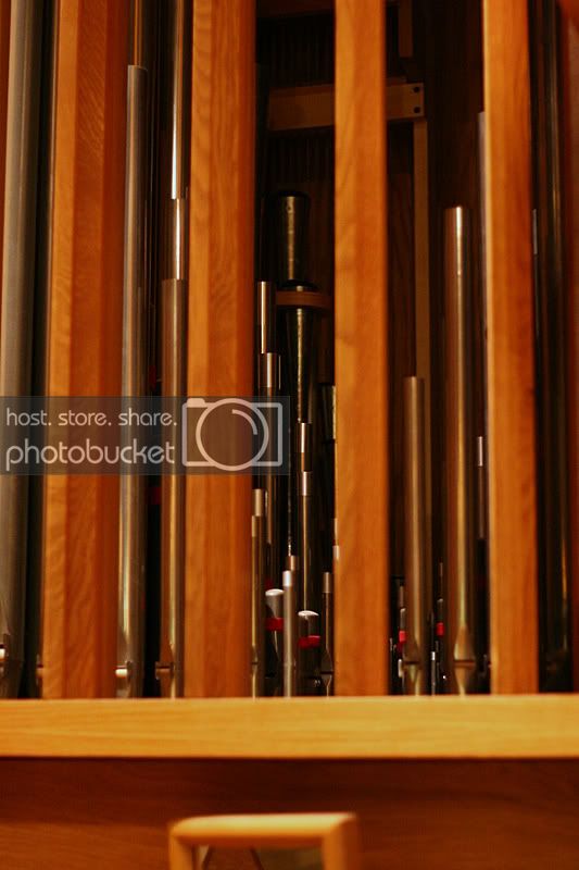

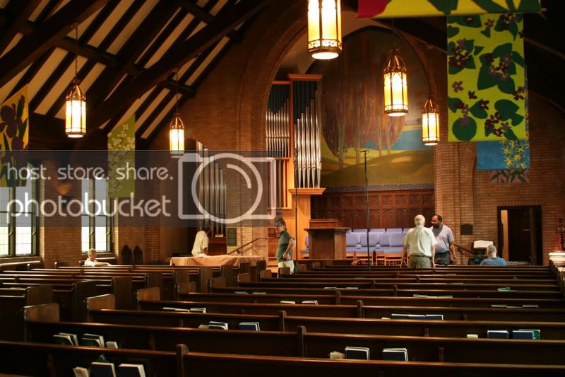

More organ:
The Cathedral:
I do not have any pictures of the actual performance as no one could move about while the recording was going on. We could breathe tho...//content.invisioncic.com/y282845/emoticons/laugh.gif.48439b2acf2cfca21620f01e7f77d1e4.gif

Not going to lie but that would be terrible mic placement. //content.invisioncic.com/y282845/emoticons/fyi.gif.9f1f679348da7204ce960cfc74bca8e0.gif
Looks like the left and right mics are going to be VERY time lagged between each other for a mono instrument . They also seem in a prime location for picking up 2nd & 3rd reverberation from the walls directly adjacent to the organ. Oh well, what do I know, I have only been doing live sound and installs in churches since I was a wee lad...

I want to test myself, where would you place the mic then?

I appreciate your honesty here and would like to add that I dont know a thing about recording live events myself. The person who recorded the session is a very well known producer and he has a lot of experience in this field (He has done some recordings for the Saint Louis Symphony Orchestra) so I trust that the things he did were done for a reason.
yea, it doesnt seem as if the mics are placed far enough apart, usually you want a 3:1 ratio
(ie if the mics are 1 foot in front of the pipes, they need to be 3 feet away from each other)
Look like they could be Neumann microphones.
Well... The mics aren't far enough apart if they are going to be doing stereo, which I wouldn't do anyway. I would have done an arc of mics or one microphone about 3-7 feet off of the middle of the vent tubes. Depending on the room (and most churches **** anus for acoustics) I would probably use one microphone positioned in a equal distance behind the organ. If I decided to multi mic probably would have used some Sennheisers on the mid-frequencies, a RE20 EV mic on the LF, and a good Condenser on the HF pipes. But, then you would have to multi-track the recording and run filters on it once you got back to the studio. So, honestly I would go for one (maybe two) microphones using that 1:3 rule and keeping it semi-close to the organ to keep the room acoustic factors to a minimum.
Sort of like this:
M
O M
O _M
O M
M
M= Microphone
O= Organ
In case you didn't figure that out //content.invisioncic.com/y282845/emoticons/wink.gif.608e3ea05f1a9f98611af0861652f8fb.gif
I am sure the recording came out perfectly fine and will sound awesome, but I am VERY anal about microphone placement and live sound/recording.
That mic is a bit further away than the pictures make it look I think. Depending on the mic and its pickup pattern, whether that be a cardioroid or bipolar could make a big difference.
those are most definitely not bi-direcetional pattern microphones... if its the nuemann im thinking of (184s) they are cardiods, but its kind of hard to tell, so i doubt its a 184
