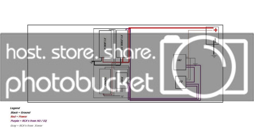

Heres a diagram of my power wires and RCA's
And yes, I see tha tthe wires going to the X1.800.4 go aross several power wires, so i rerouted them against the back wall of the stow n go where they don't cross power wires.
Did you ever consider the fact that it could have something to do with your vehicles' electrical system?
Just remember not to rule that out....
That's what I've thought all along.... noise from my electrical system is radiating into my headunit, causing noise.
