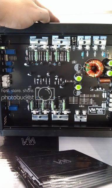

Had this **** beast dropped off today, and well....yeah. I had a few minutes between jobs coming in to crank it up quick, I can do something a little more detailed with more pics if anyone wants but I think this tells the story. First off, whole stole the rest of the guts?
Before we get to numbers here's a few things I noticed:
1. The gain is junk. At full low the amp still puts out a fair amount of sound even with less than 0.5 volt input. I didn't meter the output voltage but at 1000hz it was plenty of sound to hear from my showroom with the speaker in the bay on the bench. Why this matters: Noise Floor! This amp is going to hiss, squeal, whine like nuts. And if you have a good HU/crossover/EQ ahead of it feeding any sort of good input voltage it's going to clip hard real quick. If I have time later I'd like to hook it to one of my 5 volt Sony radios to test this. The manual says it'll take 8 volts. Um, no.
2. It's built dumb. The terminals are under the edge of the endcap, so you have to remove the endcap plastic thing to hook it up.

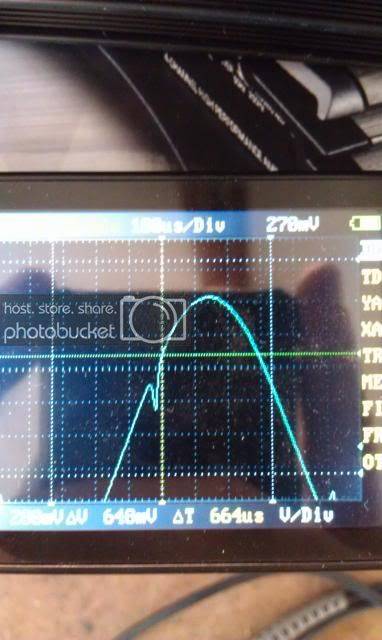

Same setup playing 1000hz got to 10.9 before it clipped. I also noticed an oddity in the waveform, which is the picture below. That notch certainly doesn't belong there. It's always there regardless of how hard the amp is playing. Also the wave constantly shifted up and down while playing the tone, meaning that the output level was varying up and down a few volts even when it should have been holding dead steady. I tried another speaker to verify it wasn't some odd impedance thing and it wasn't.

Here's the pic of the notch in the wave:
Looks like a piece of shit
