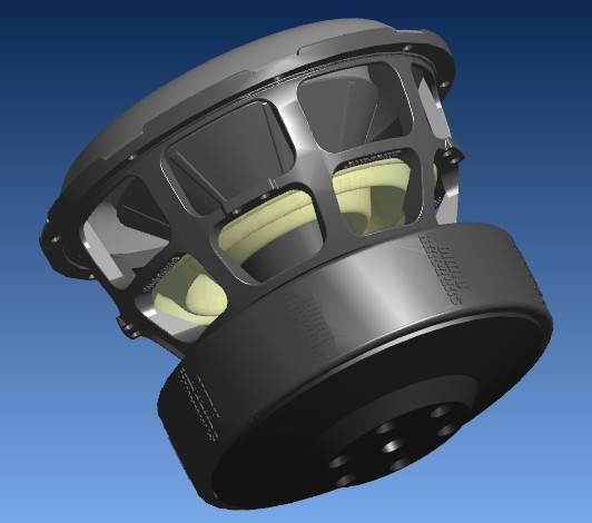

Newly tooled frame, cone, surround, dust cap, spider, etc...
600-watts RMS / 2.5" coil
I'll have a general idea on what they will cost next week //content.invisioncic.com/y282845/emoticons/smile.gif.1ebc41e1811405b213edfc4622c41e27.gif
It is a bit over-sized as I wanted a full 7" spider -- so the cut-out is 8.5" giving it an actual SD of true 8 inches (8 inch effective diameter).

Then what is the real difference in this. The sa-8 can take almost the exact same of power as this. Is it geared for spl?
The SA-8 is a 2" coil driver rated for 400-watts RMS using a standard frame -- limited pretty well to 25mm max throw in one direction before soft parts get unhappy. It has 16.5mm linear one-way but will continue to push the driver up to the 25mm mark.
This driver, the X-8, is a 2.5" coil driver rated for 600-watts RMS using custom everything -- the suspension is LINEAR for 35mm one-way with 19mm linear motor travel on-eway / 30mm max magnetic travel before leaving the gap. So it is pretty much impossible to strain the soft parts (the spider will actually support more than the frame is capable of) -- which is important as this driver is predicted to have over 50% more motor force factor than the SA-8 so would shred more standard parts in a hurry.
The suspension (spider / surround) was over-built to such a degree to support any future motor designs I may wish to use -- in case anyone was wondering //content.invisioncic.com/y282845/emoticons/smile.gif.1ebc41e1811405b213edfc4622c41e27.gif The frame will support over 40mm rearward before the triple joint area hits the top plate.
