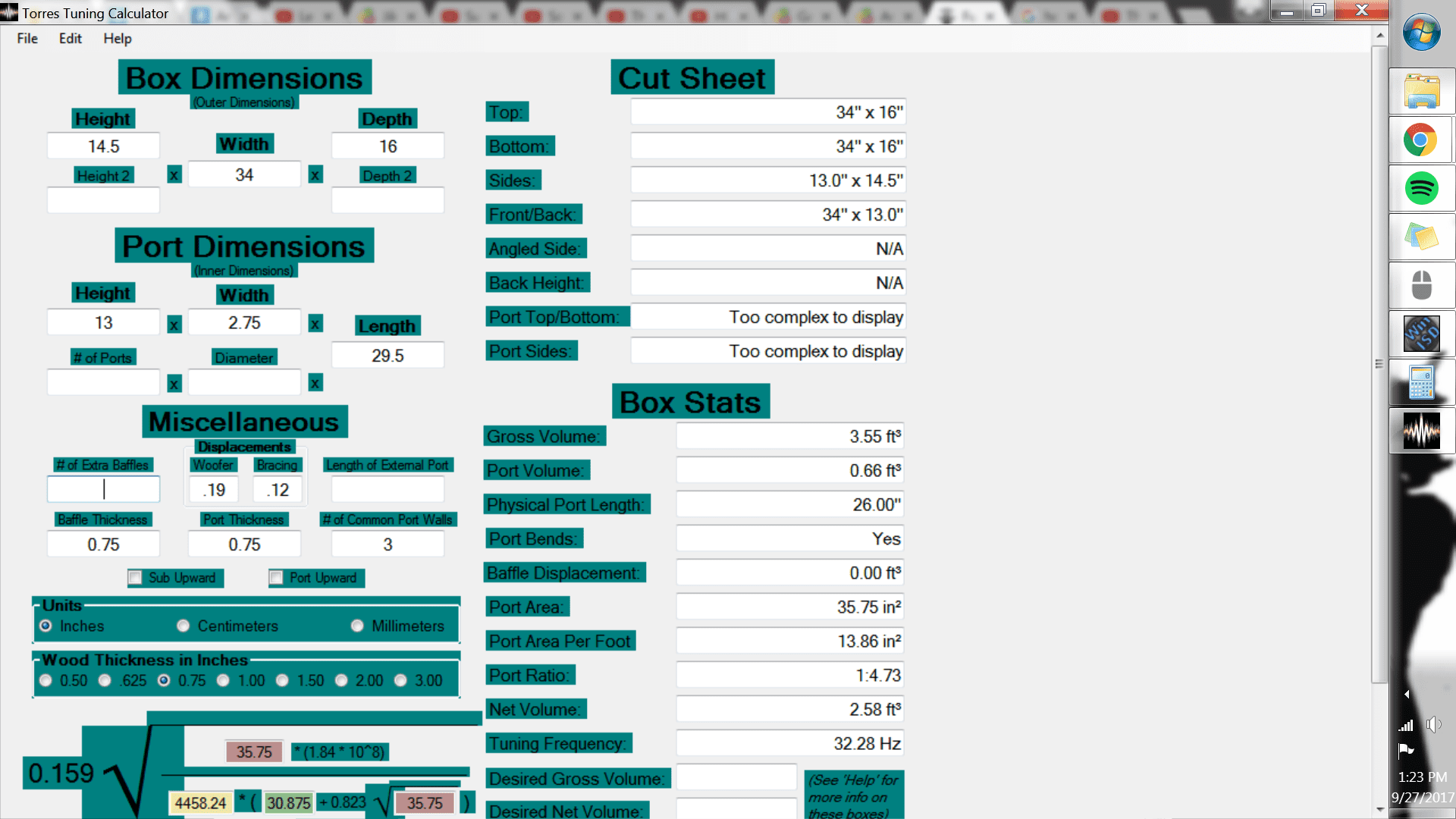

check it.. 34" x16d x14.5h 2.75"w x13h port 29.5" long sub has .19 sub disp corners and bracing around .12 cf rear port board .095 cf should come real close to 2.29 cf ad give or take.. .03.. should tune to 35hz.. as far as corners and port corner i got design from ssa site..

thats not tuned to 35hz its tuned lower and you have more airspace then you think.
Might wanna shrink your port in all honesty to 2.5 width and with the airspace saved, you should double baffle the box, the sub is over 30lbs dude. With your port, You are building it like you have a 3k amp to power it which will equal to almost 1.5k after rise while you just have a tiny little p1000.1 which will make 500-600 wired to 1 ohm at best after rise at best if you clamp it.

model it.. with the vas and bl input in wins not just the q's and it shows port air at 65 fps with 485 watts (which i think is what i have at 2 ohms (cause amp tested at 610rms at 4 ohm so should be just below that after rise right?)
