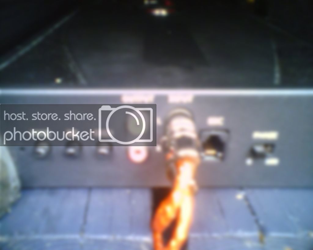

Well the amp also has an eq dial which I thought was for the purpose of the frequency it should play at but messing around with the frequency more again today it seems to let in a little vocalization into the sub, so that would be like a filter right? If I get a sealed box would that feature not even matter?
From the sounds of it you have a low pass filter that isn't adjustable. Like i said before the EQ is going to be the amount of bass boost, and the frequency is going to be the center of the range of frequencies being boosted.
one more time...turning the frequency knob all the way down, whether or not it is bass boost or low pass filter, will not have any negative effects. Try it and listen for what it does. If the volume seems to decrease/increase when you adjust it, it is bass boost, if not, it's the low pass filter
mine has no hi/lo pass switch. it's a subwoofer mono amp. built in lo pass.
